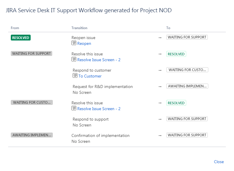

Well, here is what I setup:
My Workflow:

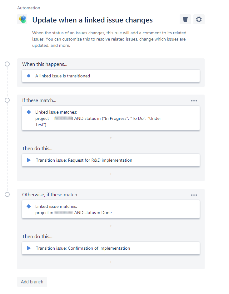

Then I created an Automation:

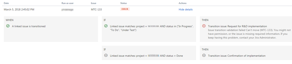

The automation is working fine as soon as I modified the linked issue, but I have the following error:
What am I missing ? Where can I find more information about this error ?
Thanks for your support.
laralg
March 5, 2018
Pierre do you have a field thats suppose to be filled or mandatory in that transition? If Jira is specting an field or validating information in that transition the automation will not be able to take place.

Pierre-Henry Deliège
March 6, 2018
No, I didn't configure any field required for the transition.
Is there a log or traces where I can have more information about the error ?
Thanks,
Gezim Shehu [Communardo]
March 6, 2018
Is the user which runs this rule, granted Transition permission for the linked/main issue project?
March 6, 2018
Ehhh... If I well understood you... The Automation that I wrote tries to change the transition on the linked issue, correct ?
March 6, 2018
Yes, I confirm, the Rule tries to change the Transition on the Main Issue (MTC-133).
So, this is correct.
Now, the option of the Rule specify to run the Rule using Project Default (myself) and I'm the administrator of this project. So it should be fine.
