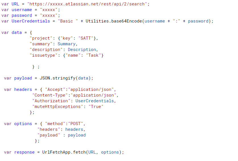

Im trying to write a script to create a Jira Issue, when a User fills out a GoogleForm
I keep getting the following error
here is my code
The fields Project, Summary, Description and Issue Type exist in my Workspace
Can anyone help me ?
thanks
Phil

Hi @Phil Walburn,
POST URL seems wrong. It should be like "....../rest/api/2/issue".
Here is the link; https://developer.atlassian.com/cloud/jira/platform/rest/#api-api-2-issue-post
Tansu
Phil Walburn
June 5, 2018
Thanks @Tansu Akdeniz
that fixed the problem

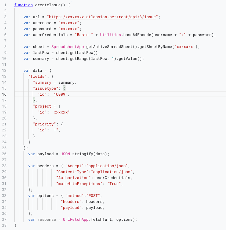

Does anyone know how to use information that you pull from your spreadsheet for your
var data = {"fields": ?
In general the script works. As soon as I add variables that refer to my spreadsheet it doesn't work though.
My code looks like this
Thanks
