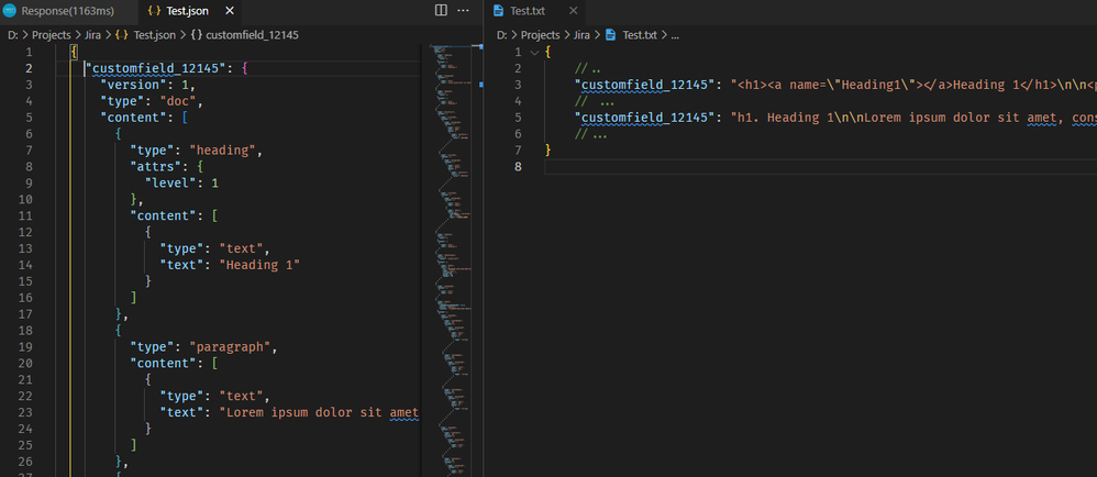

For this we currently use the Jira REST API to get the necessary Fields from a given Issue.

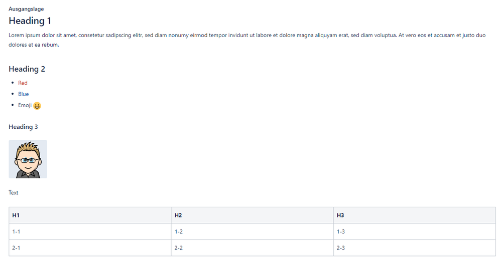

Number and Text fields are no problem. Unfortunately, we also need to use formatted Fields like this one:
The API just give us here some JSON (default) or ADF / XML Result.
Is there any easy solution or way to convert this result into a Microsoft Word Compatible form?

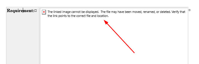

@lintek214 This is not what Jörg needs. As he mentioned, he wants to create a specific Word document. Therefore, in my opinion, the standard Word export is not useful to him.
In his picture it is evident that the field "initial position" is a "wiki style renderer" field. If I reproduce this in this constellation of him and trigger a Word export as you suggested, I get the following error message in the Word file.
