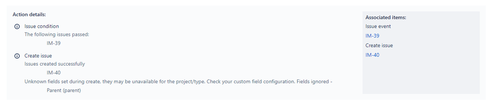

This isn't really helpful because I have changed my rule so I am not sure how I had it configured but here is the error:
It created both my story and epic but did not link them - can someone please advise me on how the rule should look to create multiple stories (with subtasks) automatically underneath an epic when it is created?

Katie, I believe what is happening based on what you describe is the rule is getting confused by what "parent" is when you try to create the sub-tasks.
Focusing on just what you are trying to achieve, I have seen this solved with 1 or 2 rules.  Here is the 1-rule way.
  • trigger: issue created
  • condition: issue type is epic
  • action: create issue, as a story, including a set of the Epic Link to the trigger issue.  Please note: Epic Link is used for a company-managed project.  If you are using a team-managed project, set the Parent instead
  • action: create issue again (as you wanted 2, correct?)
  • branch: on created issues (this should iterate over the stories)
    • action: create the sub-tasks

This solved it! I was looking for parent instead of epic link.
