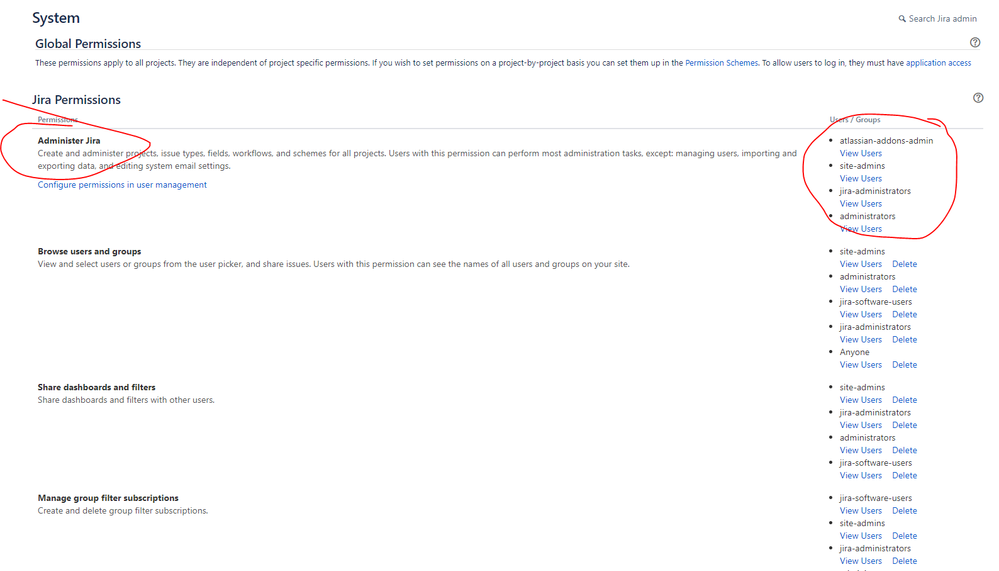

This issue may be related to two things: Permissions or Browser/Network.
As you are an administrator, please check the page below (just change to your instance name) to see if the permissions "Administer Jira" and "Create independent projects" are set correctly.
By default the "Administer Jira" is for administrators, atlassian-addons-admin, site-admins and jira-administrators.
https://yourinstance.atlassian.net/secure/admin/GlobalPermissions!default.jspa
If the permissions are already correct, can you please test using another browser? If even though another browser doesn't work, test using another network.
Please, give a try and let us know how it goes.

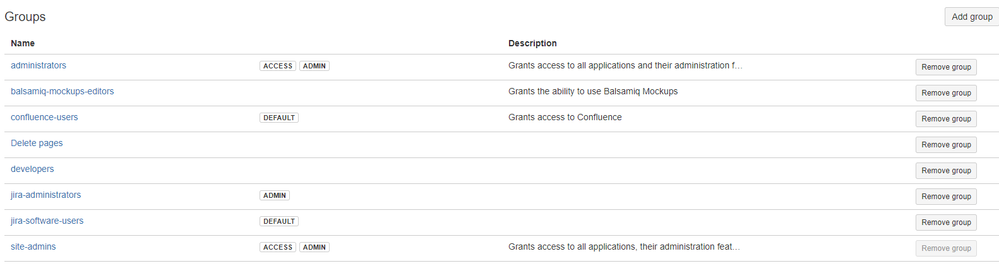

DB
August 5, 2018
thanks Angélica!
same happens in other browser/network.
the button is visible till page load completes, and disappears :(
permissions:
