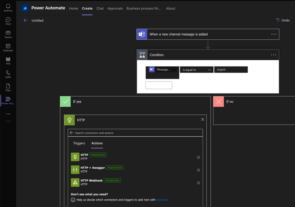

I believe you can do this with the Power Automate feature from Microsoft. You'll need to check if it's avaible for you, then you can do a flow with a trigger "When a new message is posted" for a specific channel, and add conditions (like a flag value for example).
Then you could add an action "HTTP request" where you would send an API call to Jira to create an issue, using the Teams message content.
I could create something like this very quickly :
Let me know if this helps,
--Alexis

Hi Alexis,
Looks like this solution is for creating a JIRA issue from a channel, not a Teams chat.  Do you know if this solution, or any other, that will work from a Teams chat?
Look forward to your thoughts and please reach out with any questions on my end.  Very much appreciate all of your help.
