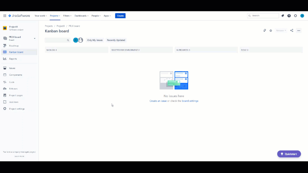

Hi Support/Community,
I am new user to Jira, and register for the free tier. I have created a project however, if I tried to create an issue, nothing happened. There is no filter on issues, also, I checked my permissions. I am the only one of the site (admin/user).
As shown below:
Tried to click the create button (no response)
Tried to click on the "create an issue" link below, and no response.
Appreciate your help

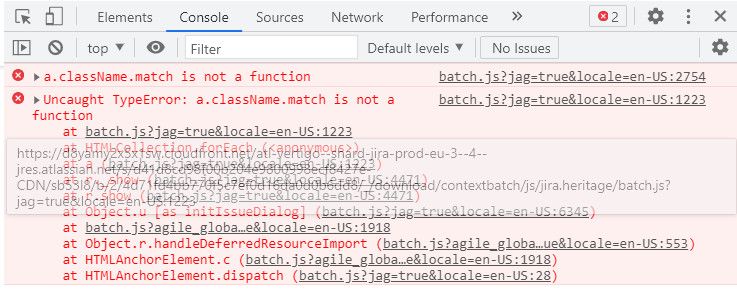

helhadad
June 29, 2021
Thanks @Linda Hamilton
Below is what I found from console when I clicked the create issue link:
