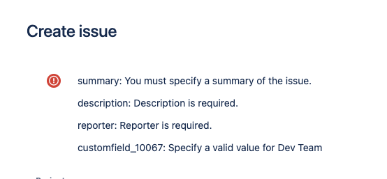

I am looking to create a URL that preselects fields for an issue creation screen. This is the URL:
https://[our domain]/secure/CreateIssueDetails!init.jspa?pid=10001&issuetype=10005&customfield_10067=Platform
This is throwing this error:

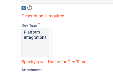

customfield_10067: Specify a valid value for Dev Team
And it's not selecting "Platform" as it should (see screenshots).
The custom field type is a multi-issue selector. What am I missing here?

Hi @Jessica Kizmann ,
TBH I haven´t ever tried this way of creating issues. As the field seems to be a multi-select field and from what I can see from this documentation a multi-select field takes an array of strings or the id of the value.
Could you please give it a shot wether this solves the problem?

I know how to find the ID of the Custom Field itself, but do you know how I can find the ID for the value? (In my case, the ID for Platform)

mkay. just tested this in my site and could only do it with the ID.
usually i get such information via the API. So in this case I chose the needed option in an issue and did a "get issue":
<your_domain>/rest/api/3/issue/{issueIdOrKey}
This will return a JSON of your issue. You can then search for your custom field and it will show the value and the value´s ID. I just tested your call with the option´s id and it worked.

Thank you Stefan! That worked!
