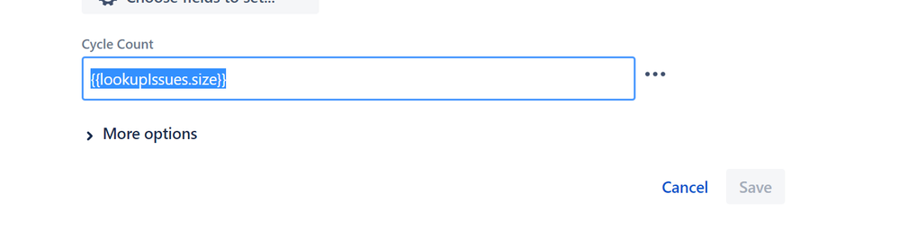

I have a question regarding to the function {{lookupIssues.size}}. With that function we want to count our linked issues.
Our use case is that smartphones get linked to a purchase order and with our field "Cycle Count" we would like to see how often the smartphones were linked.
But now this seems to not work, even though no error is shown in the audit logs.

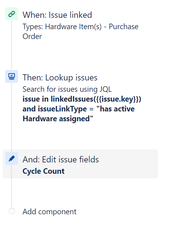

We created following automation:
Maybe someone can help us with our problem.

In what way exactly is this not working? Are you not getting the value you expect from {{lookupIssues.size}} ?
Have you used the JQL you have in the Lookup Issues action in the Advanced Issue Search screen to confirm that it is actually finding any matching issues? Of course, you will need to substitute the actual issue key value for the smart value when you do that.

Ok so you mean to give our following JQL in the search field: issue in linkedIssues({{issue.key}}) and issueLinkType = "has active Hardware assigned"
Thank you in advance!
You will have to replace {{issue.key}} with the ID of an actual issue that triggered the rule.

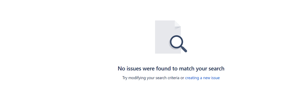

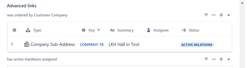

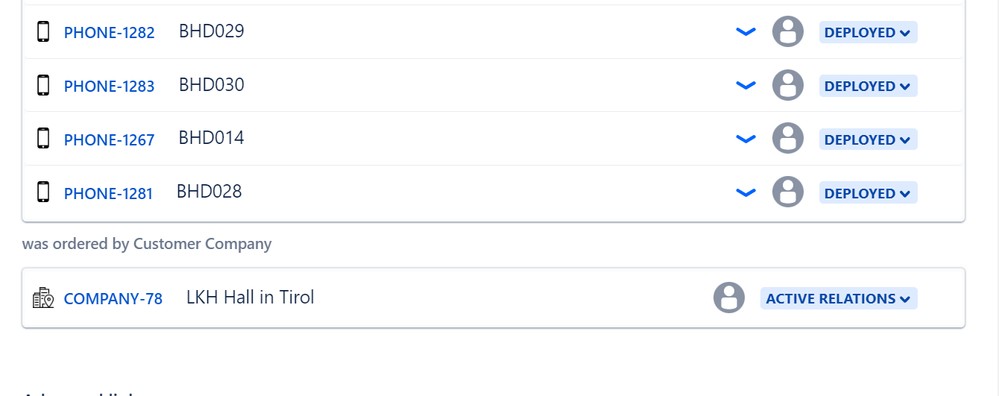

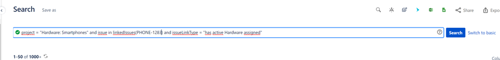

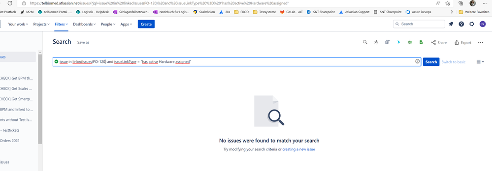

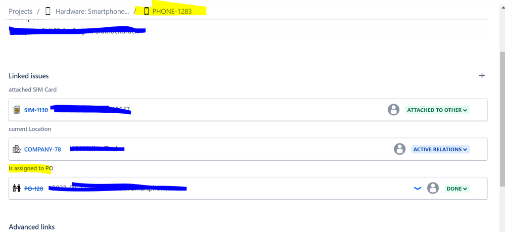

Now I did following:
1. see Picture "Step 1"
2. No issue were found see picture "Result"
3. But phone has got one link see picture "PHONE-1283"
The filter you showed in your Automation Rule and the filter you showed in your Advanced Issue Search are not the same. You added
project = "Hardware Smartphone"
...to the Advanced Issue Search. Remove that so that your Advanced Issue Search matches the JQL in you Automation Rule to see if the you get any results.

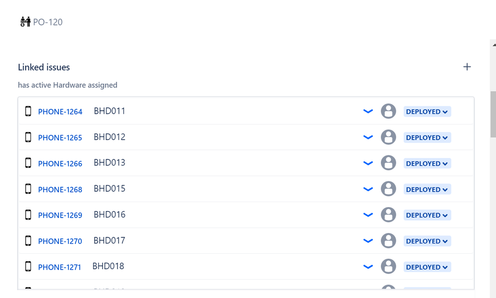

Also, please show the Linked Issues section for PO-120.
Ok thank you for the hint.
You can find attached the Linked Issues section for PO-120 and also the new filter search for the automation rule- is this correct?
