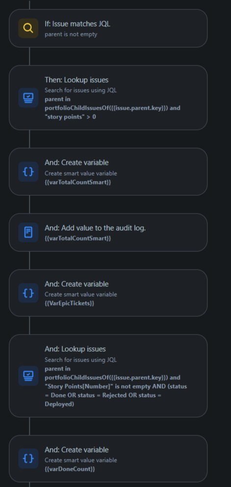

Hello,
Created automation rule for Initiatives that should count its completion rate [%] from SP.
As Initiatives are above Epics, i triggered this rule from changes in "Epic completion rate" that is under the Epic. this field is also using automation to calculate it.
The problem with Initiatives is that they need to run on ALL the epics and their children - count the total SP and the completed SP and make the calculation.
In the below rule you can see my logic but for some reason the numbers are not good - and i suspect there is a limitation on the number of tickets a "Lookup" step can run on?
For example, i get 170 Done SP and 215 Total SP although the real numbers should be much higher...

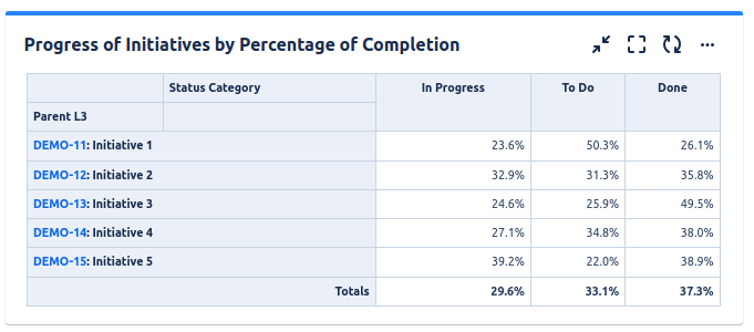

Instead of struggling with the automation rules and all kind of Jira limitations, an easier alternative for displaying the SPs completion on the initiatives is to use a report or gadget that is capable to determine the SPs completion for the initiatives.
By using the Advanced Roadmaps feature in Jira Premium you might be able to display this info. See https://www.atlassian.com/software/jira/guides/advanced-roadmaps/overview#how-do-i-track-and-report-progress
Also, you could search for a plugin on Atlassian Marketplace that is capable to do this of calculations.
If you consider the idea of trying a plugin, our Great Gadgets app offers a Pivot Table & Pivot Chart gadget that can calculate percentage of SPs completion for initiatives with just a few clicks!
For more details, see this article: How to display the progress of Epics or Initiatives in Jira or Confluence by using Great Gadgets app

Based on https://support.atlassian.com/cloud-automation/docs/jira-automation-actions/#Lookup-issues I think that you reach lookup limits.

Yes this makes sense. i wasn't aware of this limitation...
any suggestion what i can do in that case? in this example i had 205 tickets to run over and make the calculations
