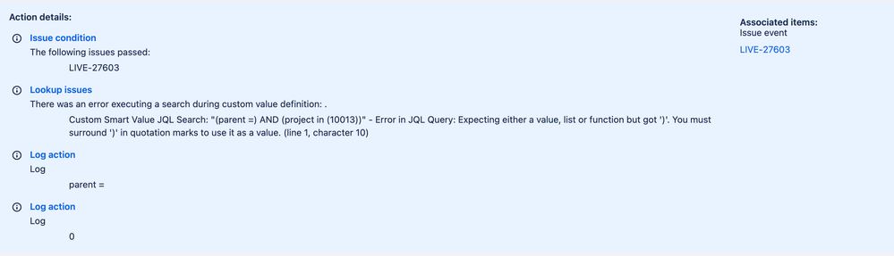

Petar Cvetanovic
July 15, 2024
I got this error message.

Bill Sheboy
July 15, 2024
Hi @Petar Cvetanovic
First thing, "project" already has a specific meaning in Jira, and so creating an issue type with that same name may have unintended consequences (e.g., cause confusion, lead to automation rule or JQL errors, etc.).  Please use cause in automation rules to confirm the context is correct when checking for the issues.
Please post an image of your complete automation rule for context.  That will help the community to offer better suggestions.
Until we see that...
The error you show in the audit log indicates this rule triggered for an issue which does not have a parent.  To solve that symptom, add a condition after the trigger to check if the {issue.parent}} is not empty, or restructure the rule so it only proceeds when there is a parent:

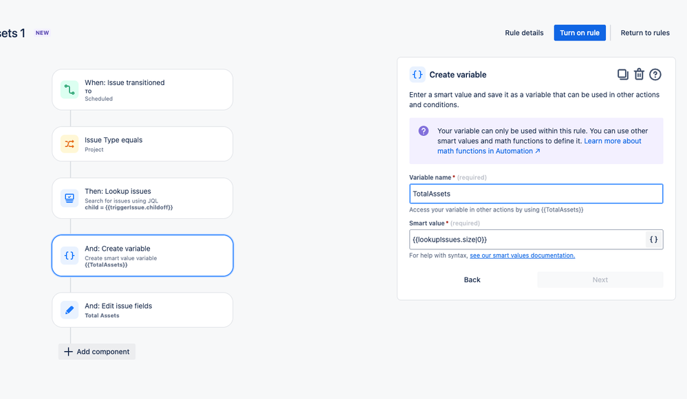

Petar Cvetanovic
July 16, 2024
Can we automate the opposite way? I need all use cases covered, and I think the opposite way is a lot easier.
How I would do it logically
Trigger - on the transition to status "Scheduled"
Condition - issue type project
Action 1 - Lookup all issues that are (child off parent) of linked issue type and
Actopm 2  -vCreate a variable {{TotalAssets}} that is equal to the lookup issue count
Action 3 -  Set Custom Issue Field Vavlue {{TotalAssets}}
I think this is an easier solution than what you suggested. I will just need help with looking up and counting.
See video exp -https://www.loom.com/share/bb1ef14342ad4d45adc2268de6a69580
Screenshot of the suggested rule
