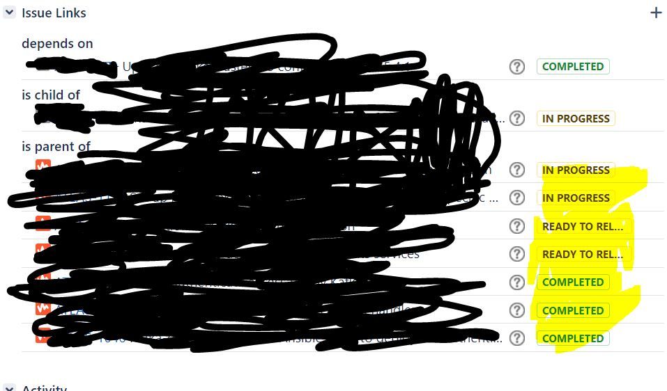

Attached is the section ("Is Parent Of") from the issue link which shows that there are total 7 tasks (vs query shows 5) and completed 3 (correct). We do not understand why/where the other two have been linked?JIRA issue links and inheritence.JPG

The JQL which shows "Current Number of Tasks" as 5 (as opposed to 7 according to the above image)
project = DUMMY AND "Epic Link" in (TOM, DICK) AND labels in (label1,label2) AND issuetype in (Story) ORDER BY issuetype DESC

I have checked this again. Here is the problem.
1) We opened 7 tabs with all 7 child issues visible from Issue Links.
2) We unlinked-and-relinked issues 1-by-1. We have identified 3 issues which are not getting identified as we link them using "Is Child Of" from story.
I believe this is a bug at Atlassian/Jira side. There is nothing wrong with that issues in terms of how  they have been configured. We have also checked that.

This is what happened so far
1) We identified 4 tasks under that user story which matched with the "Current Number of Task" column (A1, A2, A3, A4)
2) The other 3 tasks (A5, A6 ,A7) are somehow dependent of/required for other tasks.
3) As soon as some of the dependent tasks e.g A5, A6 were transitioned to "Done" - we suddenly see 7 tasks in "Current Number of Tasks" column.
The above seems to suggest that it's a lack of functionality and documentation from JIRA's side. From a user's perspective, if there are 7 child tasks of a story, "Current Number of Tasks" Filter Column should always show 7 (not more/less). Alternatively, there should be a clear documentation explaining what "Current Number of Tasks" column mean for Filter Results - which doesn't exist today.
