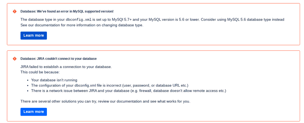

It used to work fine but some days ago it doesn't ( could not recall what change we made),  you see see as following capture:
To clarify, my data is mysql 5.7. I have checked dbconfig.xml, the user name password is correct.

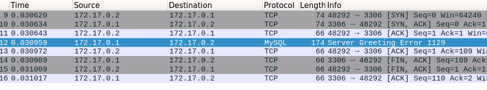

When I manually connect to mysql database with command line from jira server, it says "ERROR 1129 (HY000): Host '172.19.0.1' is blocked because of many connection errors; unblock with 'mysqladmin flush-hosts'"
Then I go to mysql server and mysqladmin flush-hosts, the connection still could not be established, get the same error.
But in mysql server, use command "mysql -u mydbuser -p", enter password, it is ok and could see jiradb database.
Please help asap.

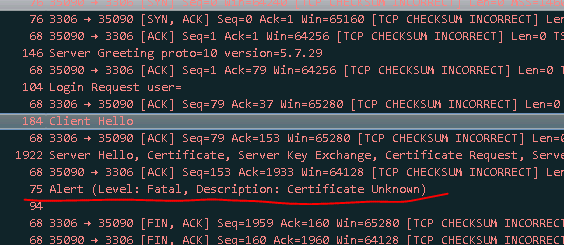

OK  I understand now.
I have set Jira/confluence server communicating with mysql over SSL, but later the SSL certificate is out of date but I didn't notice.  Jira or confluence won't accept expired or invalid certificate and refuse  to continue. It seems confluence quickly retries numerous times ("mysqladmin flush-hosts" won't help because hit threshold in one second) so that mysql considers it as some attack and let it into blacklist.
This is proved in this packet capture:
refer to
https://community.atlassian.com/t5/Jira-Software-questions/WARN-Establishing-SSL-connection-without-server-s-identity/qaq-p/1015860
https://confluence.atlassian.com/confkb/getting-establishing-ssl-connection-without-server-s-identity-verification-is-not-recommended-warning-messages-in-the-logs-973502769.html
After fixing (remember stopping jira/confluence and "mysqladmin flush-hosts" db), it works now :)  Another solution is to renew certificate.

My database is MySql, no MS SQL. And yes, I tried to reboot many times but it doesn't help. I don't think it is blocked by port. As I did wireshark capture, the connection is OK but MySql returns server error, the content is simple: blocked because of many connection errors; unblock with 'mysqladmin flush-hosts
I don't know what causes too many connection error,  and "mysqladmin flush-hosts -h localhost -p" in MySQL server doesn't help.
