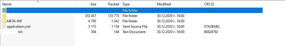

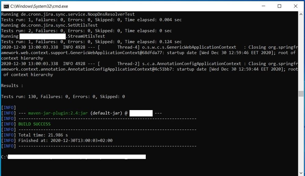

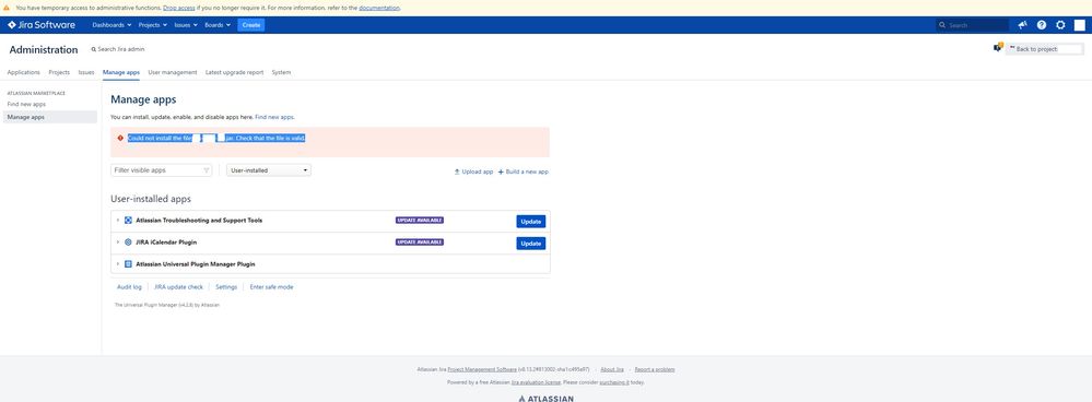

Hello Everyone. I am playing with my first plugin for Jira Server - v8.13.2 (Local installation with 20+ days left.). Plugin is developed as a maven project and it is tested successfully - with running both - main method and running FAT Jar. It does exactly what it is supposed to do - sync issues on 2 instances of Jira, one local and another remote Jira Server. I am using 1.8 JAVA SDK and Atlassian SDK. IDE is Intellij. I am executing "atlas-package" and the build is successful - see on attachment. I can see the jar and I can see it has all of the dependencies. While "atlas-package" was running, it synced the 2 instances of Jira. But when I try to upload the app, I have "Could not install the file xxxx-xxxx-x.x.jar. Check that the file is valid." I am not able to upload it locally or on the remote instance, so I am assuming it is not a Env. problem. Any advice or baby stepping help will be much appreciated.

Thank you Nic Brough _Adaptavist_ , I've played with several dependencies in the pom to a point where I was able to atlas-package and atlas-run successfully(AMPS plugin dependency fix led to others and so on). I am still unable to package in a proper way. With atlas-run I am able to see the plugin, but it is not available. No errors or warnings during the execution of "atlas-package" and "atlas-run". The log doesn`t tell much.
{"code":null,"message":"Could not install the file plugin-name.jar. Check that the file is valid."},"description":null,"stage":null,"resourceName":"plugin-name.jar","resourceVersion":null,"itemsDone":null,"itemsTotal":null,"progress":null,"successes":null,"failures":null,"nextStepPostUri":null,"resultUri":null,"pollDelay":100},"cancellable":false}
I am a little bit stuck for now.
