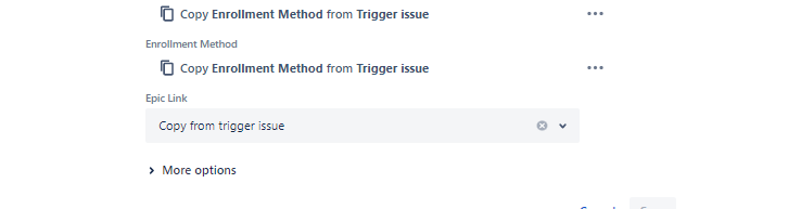

This indicates you have set up your rule to have an If/Else block.
That would seem to indicate that you want to create different sets of child Stories based on values of the created issue that triggered the rule. Is that correct? Are you indeed trying to execute different actions based on values of the triggering issue? If not then you can replace that with multiple Issue Fields Conditions.

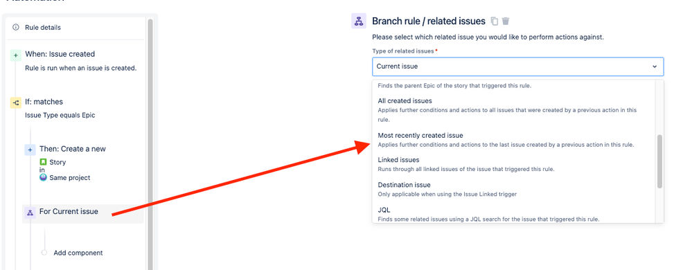

You actually can add a branch under each Create Issue block thus:

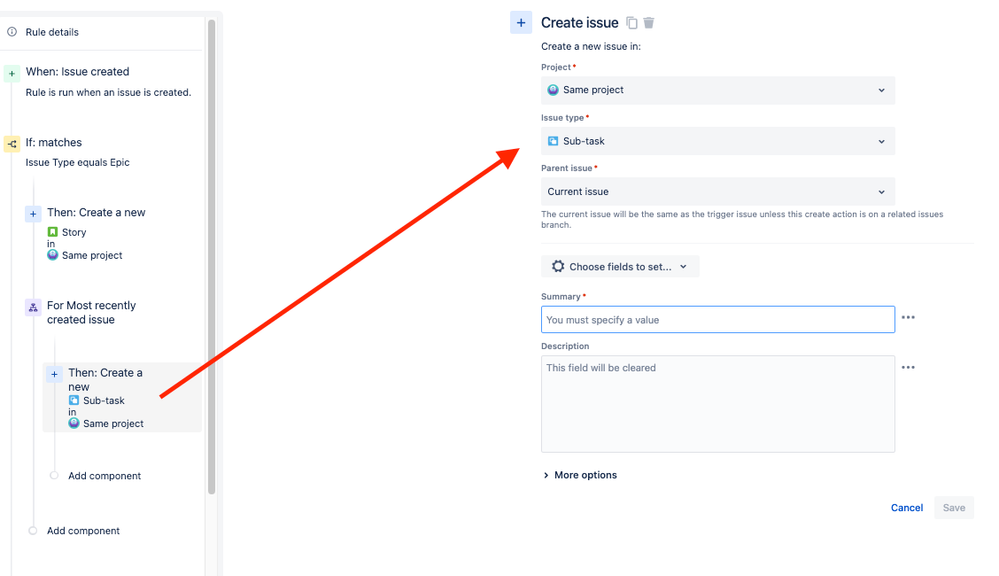

And then under that add more Create Issue components to create subtasks.
