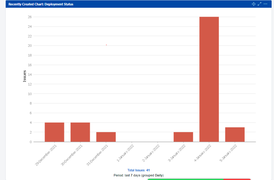

Hello,
I have created a report that shows issues resolved versus unresolved for the last 7 days. However, I see the report isn't working correctly. At the moment, all the issues are showing as unresolved on the graph even if the issue status is "Done". Please find the attached screenshot. The JQL query I am using is  - project = "Deployment Board" AND status = "To Do" AND status = Backlog OR status = "In Progress" OR status = Done OR updated >= -7d ORDER BY created DESC
I am not sure if I need to tweak my JQL query to populate the desired results. I would highly appreciate it if anyone could please help with my issue. Thank you in advance for your help.

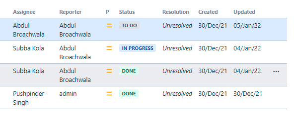

Hello Vishwas,
Thank you for your prompt response.
Yes, you are correct. I noticed that the resolution is not set as I see issues that are marked as in "Done" are still sitting under "Unresolved". Please see the screenshot below.
Could you please help me with how to set the resolution as "Resolved" for all "Done" issues, so on the graph, it will show Issues in "Red" that are unresolved versus in "Green" that are resolved? Thank you in advance for your help!

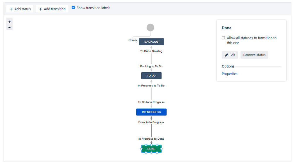

Hi Vishwas,
Thank you for the explanation. Unfortunately, I do not see the post-function option when I edit my workflow and click on "Done". Please see the screenshot below. Any idea, if there is an alternative way to add post-function? Please advise
Vishwas
January 6, 2022
Hey @Abdul Kader Broachwala
You have to click on "Done" Transition to see Advanced Workflow Configurations.
Click on this highlighted part.

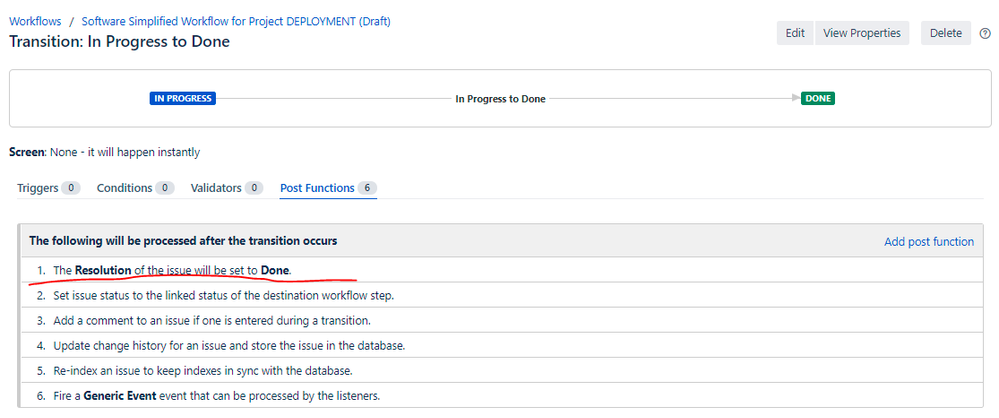

January 6, 2022
Hi @Vishwas
Thank you for the explanation. As per your advice. I have added the post-function to the transition "In-Progress to Done" and set the resolution as "Done". I also published my workflow again. Please see the screenshot below. To set Resolution for existing Unresolved issues that are in Done Status. I fall under option 1, I am selecting all the issues>clicking on Tools>Buld Changes>Only selecting issues that are Done but unresolved>Clicking on edit fields (However, I do not see a field to set resolution).
Could you please let me know if I am following the right steps? Also, for the future issues that are set to Done, will it automatically be resolved? Since now I have added the post-function in my current workflow? Please advise
Vishwas
January 6, 2022
Yes you are following the right steps and the configuration you have done looks fine.

There are three things I'd like to look at in this question.
1. You do not mention the resolution field at all.  Do you know that the right issues in here have their resolutions set at the right time in their workflow cycle?  To test this, try running your search in the standard search and check what the resolution field is across the results.
2. The screenshot is not of a "created vs resolved" gadget.  I wouldn't expect this gadget to be showing you created vs resolved, it actually looks right to me.
3. The complex one - when you mix "and" and "or" in a query, most humans get it wrong at first, and don't really get the logic.  It's not even well documented what the logic is in cases where you give Jira a potentially ambiguous query.
If you write out your query as a list of issues it is going to report on in English (I don't usefully speak any other languages apart from "gibberish" according to my family and friends, so I work in English, but the same idea can be done in most - translate your query into a list of separate groups of issues) - are you sure this is the right list?
