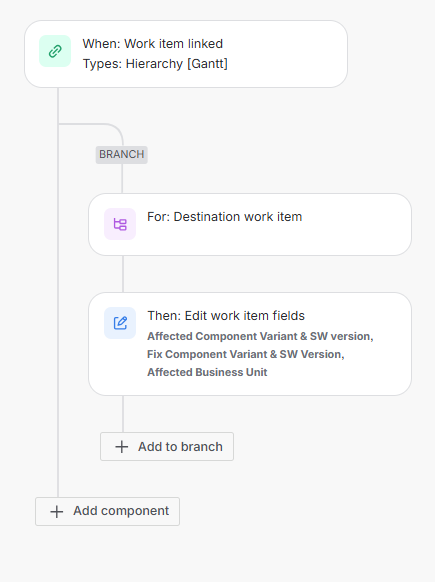

I have just been trying to create this rule with the limited knowledge i have and with the help of Rovo AI assistant. Since i have been trying to do trial and error I have not implemented the rule in full. Please find the screenshot attached. As of now, the values from the task ticket are not copied to the bug ticket when i link a bug to the task ticket.

Trudy Claspill
March 2, 2026

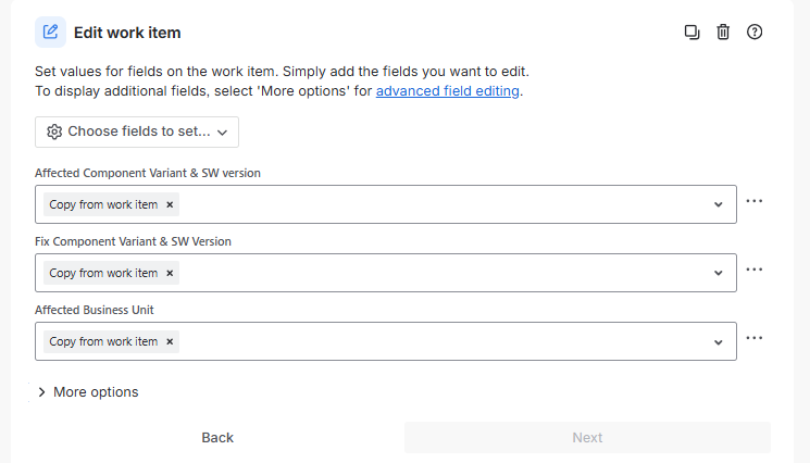

Additionally  what are the fields you want to copy and what are their custom field types?
And can you show us the details of the Edit action in your rule?

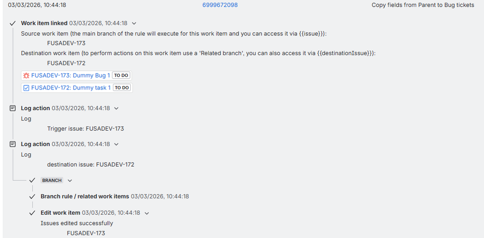

Melvin Vijayakumar
March 2, 2026
Hello @Trudy Claspill
I dont think I have JIRA application administrator because I wasnt able to see the options you have mentioned, so I tried doing the log actions after the trigger.
From the audit log, I can see that the trigger issue is the bug ticket and the destination issue is the task ticket.JIRA_Automation.png
The fields that I want to copy are mentioned in the previous reply (screenshot attached).
1. Affected Component Variant & SW version (Field type : Label)
2. Fix Component Variant & SW Version (Field type : Label)
3. Affected Business Unit (Field type : Label)
