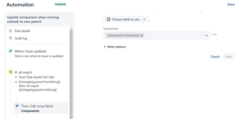

Having a hard time finding out the smart value to use for this one. We use components on both issues and subtasks, but the latter are automatically set to be a copy of the parent's component value when the subtask is created. No issues there.
But if a subtask is then moved to a new parent, I need to be able to update the component to whatever value is now available on the target parent, and am having a hard time finding the smart value for that.
This is the closest I've gotten so far, but am not getting any results. I'm assuming the smartvalue would have to be something like {{issue.changelog.parent. ...}} but cannot find any good examples on this.

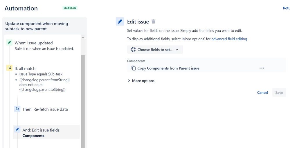

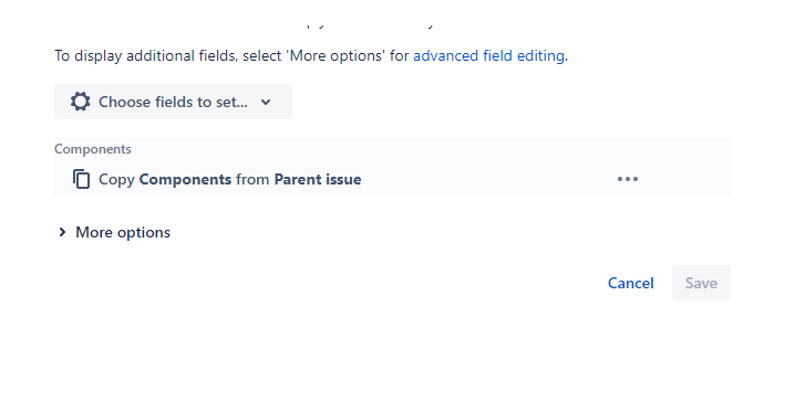

Ok, gotcha now. The timing issue was definitely the problem. I added the re-fetch and just changed the rule to be a simple Copy, and it works like a charm now.
For anyone else looking into this issue, here's the final setup:

@Stefan Salzl thanks for the answer and apologies for the late reply. I've been trying that out as well, and although there are no errors and the rule's audit log says the values were copied, nothing actually is. I have a feeling that this is because what's being copied is the component value from the current parent and not the new one.
That's why I was hoping there'd be a way to reference the new parent via something like "{{issue.changelog.parent.toValue.Components}}.
Any ideas on how to reference the values in the target parent instead of the current one?
