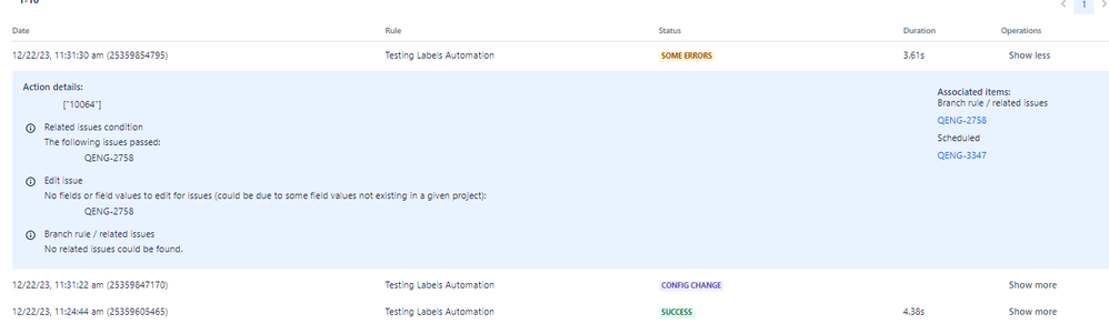

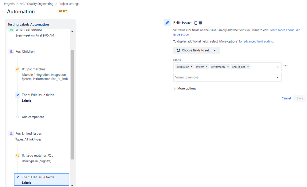

Scott Federman
December 24, 2023
Bill Sheboy
December 24, 2023
Thanks for the additional information as that leads to some other questions / insights:
You originally described copying labels from an Epic to its children Stories.  And then you want to further copy those labels to any Test or Bug (defect) issue types which are linked to those child Stories.
In automation rules, branches which could be on more-than-one-thing are executed in parallel and asynchronously.  In fact, there is no guarantee of when the branch will finish, up until the last step of the rule.  Please look here to learn more about that design: https://support.atlassian.com/cloud-automation/docs/jira-automation-branches/#Ordering-of-branch-executions
What this means for the rule you show is that a race-track condition can occur, where the same issues are potentially being edited by the different branches.  That will likely cause problems.
A common solution for this is to use two rules: one to copy labels Epic -> Story, and another to copy labels Story -> linked Test and Bug (defect) issues.  That will ensure a specific Story has finished updating before trying to change its linked issues.
