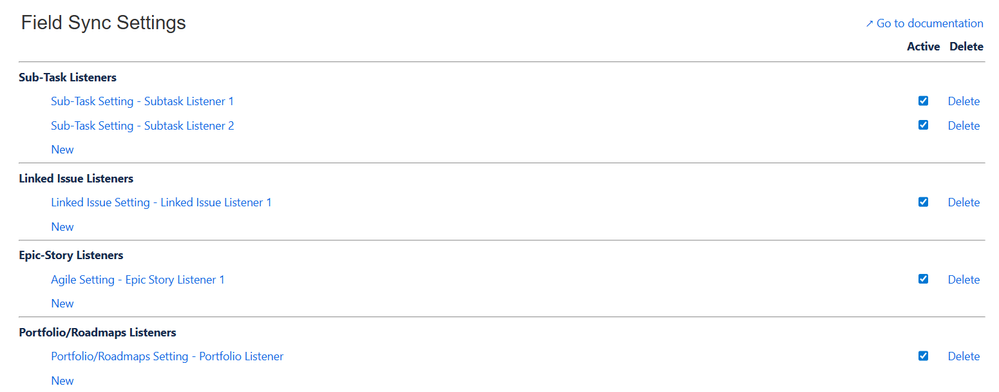

If you are open using a 3rd party app, we built Field Sync exactly for this kind of scenario. It can automatically copy field values (like your RDS Team field) from an Epic to its linked issues such as Stories, Bugs, and Sub-Tasks — and it works not only for new issues but also for existing ones. With the Sync Existing Issues feature, you can bulk-update all related issues in just a few clicks.
You can set up multiple listeners, choose which fields to sync, decide the direction, and cascade updates from the Epic all the way down to its children.

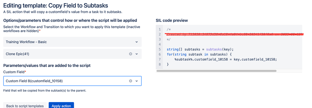

I'm gonna leave an script option for Power Scripts below, as well as an link to contact AppFire Support, which also addresses JMWE
The Script using Power Scripts - Jira Workflow Automation.
With the following scripts (which were generated from templates that the app offer)
if(!isNull(parent)) {
customfield_10158 = parent.customfield_10158;
string[] subtasks = subtasks(key);
for(string subtask in subtasks) {
%subtask%.customfield_10158 = key.customfield_10158;
Then you may easily set up as an automation or an post function for a custom status and just run it or schedule it, the template window really helps with that, as per follow:Subs.png
here is the link for the Appfire Support Team, you may ask them either about JMWE or Power Scripts.

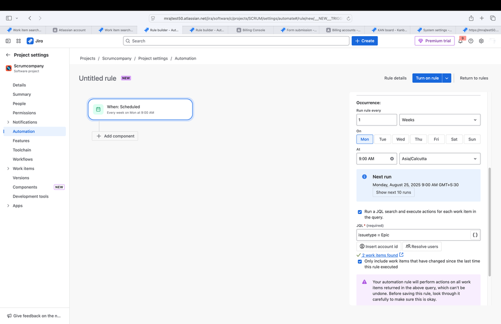

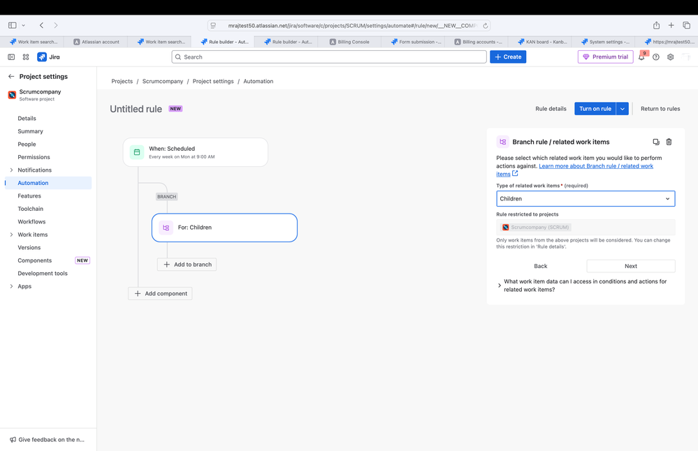

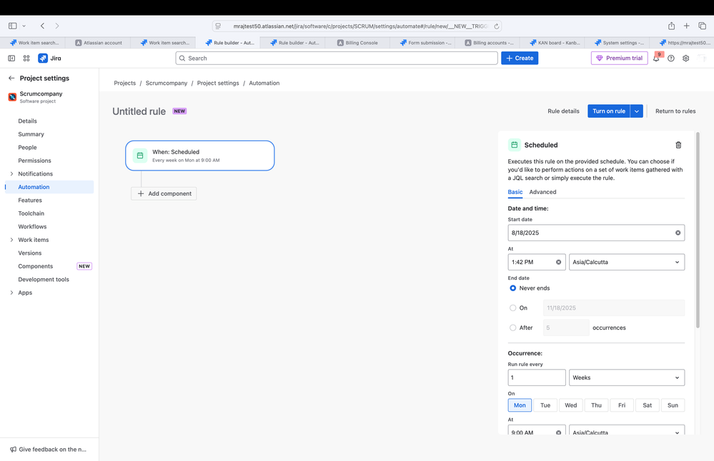

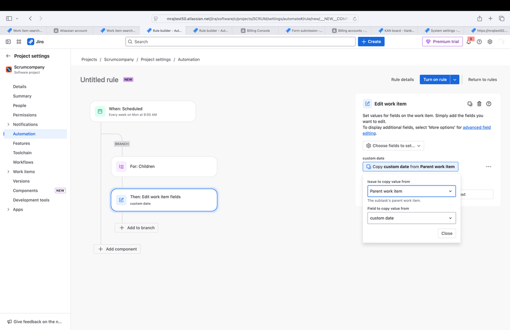

Hello, Good day. You can try the following automation rule.
Screenshot 2025-08-18 at 1.42.58 PM.pngScreenshot 2025-08-18 at 1.43.27 PM.pngScreenshot 2025-08-18 at 1.43.45 PM.pngScreenshot 2025-08-18 at 1.44.20 PM.png
