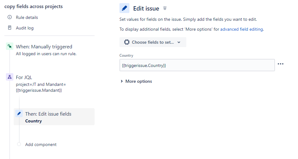

Hi @Craig ,
I tried to create a rule that fullfills your requirement (as far as I understood your need correctly ;) ). Please be aware that your rule need to be a multi project or global rule as it needs to operate across 2 or more projects.
By using smart values the rule can check for issues in project X containing the same value as the (trigger-)issue in project Y. Important here is to think of the trigger (i just picked a manual trigger, that is something you have to figure out when your rule should be triggered to run).
Below is a screenshot of what I built.
Maybe for better understanding:
  • the trigger issue is in project X, has set field: Mandant = 330 and Country = USA
  • then the jql searches for issues in project Y with the same value for Mandant as triggerissue in project X (which is 330) --> solved with smart value in jql
  • the jql finds several issues in project X with Mandant = 330 (same as triggerissue) and edits the found issues, field "Country" to the same value than triggerissue in project X (which is USA)
Hope I got your requirement right and this helps.
Best
Stefan
Craig
February 25, 2022
Thank you Stefan, it works like a dream!
Like Stefan Salzl likes this

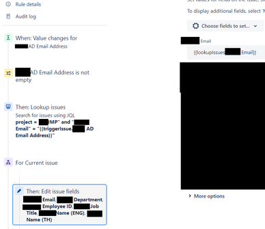

Ivor
June 9, 2022
@Stefan Salzl I have the same troubles but I don't seem to get the same outcome as described. The scenario is quite similar:
1. The trigger issue is from project A. Let's name the trigger issue to be "ISS-A".
2. The source issue "IMP-B" is from project B (from screen its IMP). Redacted for confidentiality.
3. I want to copy the fields from the issue in project B to the issue in project A.
If I follow the same triggerissue smartvalues as described, what happens is that:
1. It will copy the values from the ISS-A to IMP-B. The results are the opposite of what I wanted. I wanted to copy the values from IMP-B to ISS-A.
I attached the example of my rule below. I think I am very close to achieving what I want, but just stuck for couple of hours - maybe i'm doing this more complicated than it already is.
Stefan Salzl
June 9, 2022
Hi @Ivor
as your rule is using a branch it changes it´s context/scope of action to the issues that are found by the branch-condition:
  • the jql in your branch is selecting "ISSUE-B"
  • as the action is in your branch it is processed against ISSUE-B
I would suggest to
  • change the branch to a "lookup issue" action with your jql
  • adding the "edit issue" after your lookup issues
  • using smart values of {{lookupIssues}} instead of {{triggerIssue}} in your "edit issue" action
One more thing that comes to my mind:
The JQL seems a bit generic. Can you be sure that there is only 1 issue in project B with this email adress in the field?
Best
Stefan
Ivor
June 9, 2022
hi @Stefan Salzl
Thanks for the advice, I did the modifications based on your response and it now works. This is the final flow that works for me. Sharing the screenshot so that might benefit others.
Tbh, what I was doing was a workaround on JSM to store referential data of user information by importing that into the IMP project (which is imported manually) due to limitations on integration with an external DB/app. Each record is confirmed to be a unique, so the jql query always returns only 1 record.
I guess if there are several records that are returned by the JQL, then we probably need to set the array value to [0] to only retrieve the first object? Though it doesn't impact my use case, it would be very informative to be able to do this on datasets that have more than 1 record returned.
