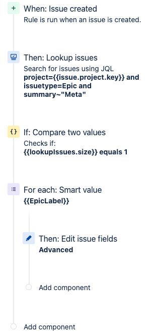

It took me a while, but I finally got it.
Edit: My apologies. My response here is copying values from the Epic's Labels field. While valuable to know how to do that, you were not asking about copying values from multi-value selection list fields. Will be back shortly with another response that shows the rule doing a simple copy from single-value fields.
Here's the overview
If you don't want this applied to every type of issue created, then you would want to add a Condition right after the trigger to check issue type.
Here are the details of each component after the trigger.

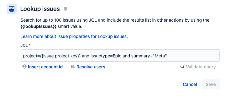

This looks for the Epic in the same project as the trigger issue, with the text you want to specify for the Epic Summary field.

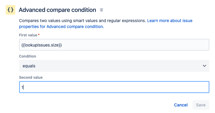

This confirms that you have found one and only one Epic that matches your lookup. If more than one is found, or none are found, the rest of the rule does not run.

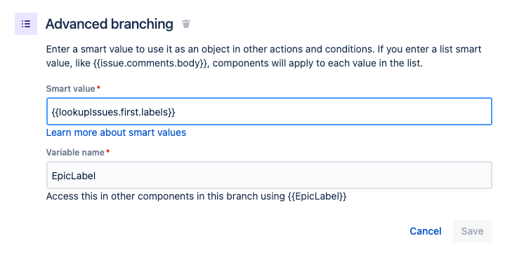

This drives an iteration through all the values in the Labels field of the found Epic, assigning the value to a variable with each iteration.

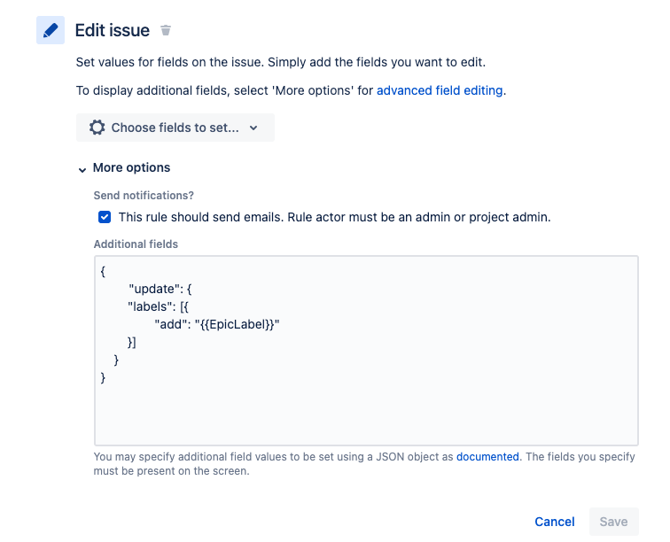

And this adds each Label value from the Epic to the Labels field of the trigger issue.

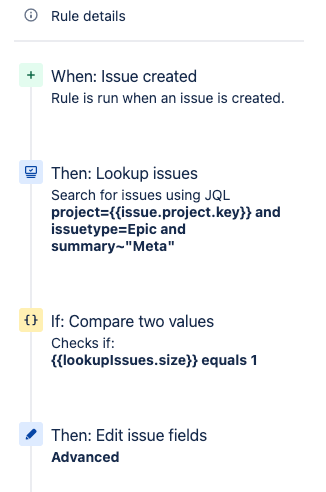

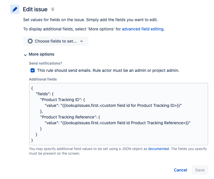

Here's the version for copying values from simple single entry fields.
You would replace <custom field id ...> with the actual custom field id for the respective fields.
