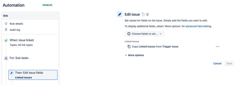

Marco Brundel
June 21, 2023
Hi @Jose Antonio Quesada ,
You can use the trigger "issue linked" and a branch For: Sub-tasks and then choose Edit Issue within the branch.
See screenshot.
Probably add a condition for your use case I think.
regards, Marco

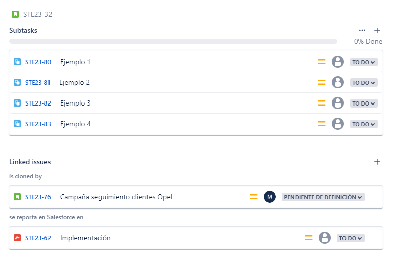

Thank you  very much @Marco Brundel but I am not succeeding.
I have this issue with Linked issues:
The desired behaviour is as follows: I want the linked tasks of the parent task to be assigned to the subtasks when they are created.

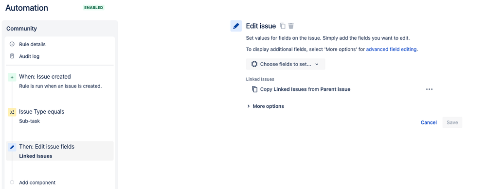

Marco Brundel
June 26, 2023
Unfortunately, there isn't a specific 'create sub-task' trigger.
But if you combine 'create issue' as a trigger with condition issue type = sub-task and then choose 'edit issue' as the action, you can choose 'field' linked issues and copy them from the parent issue. Is this useful to you?
Regards, Marco

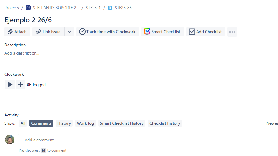

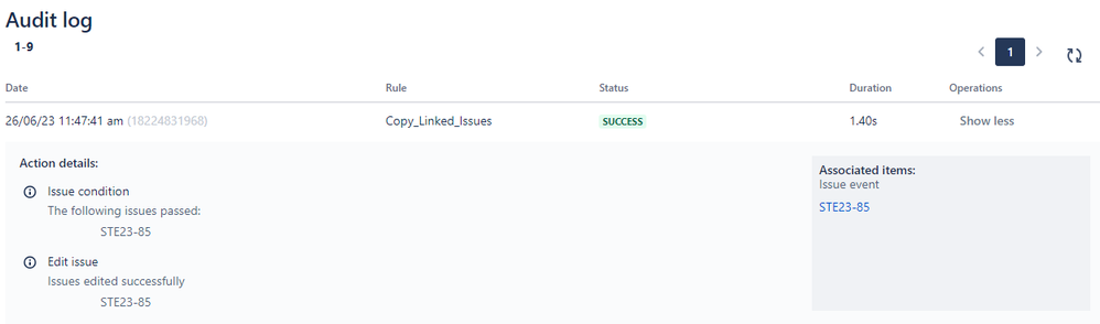

It sound goods, but it doesn't work, I don't know why??

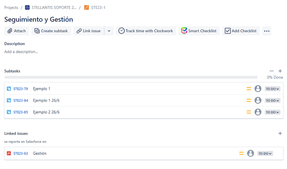

Audit log describes it works, but the linked issue is not in the issue:

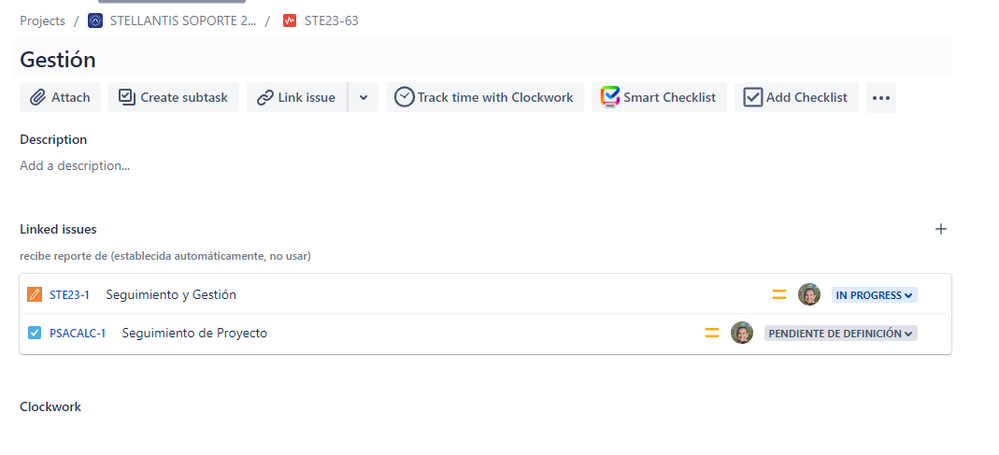

But the parent task has a linked issue:
What is wrong?
Thanks in advance?
BR
Jose
Marco Brundel
June 26, 2023
Question: if you look in STE23-63, do you also not see STE23-85 as a linked issue?
Regards, Marco
June 26, 2023
Hi @Marco Brundel
No..
BR
Jose

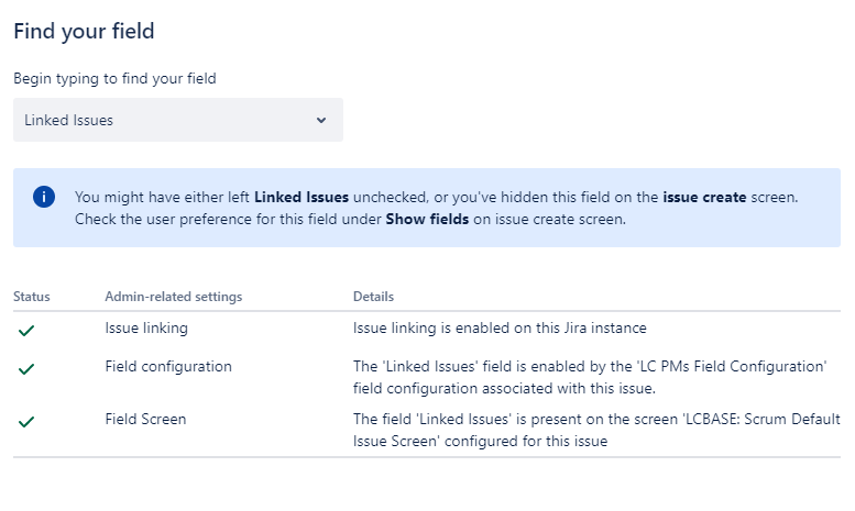

Marco Brundel
June 26, 2023
Strange, I don't have an explanation right away. Would you like to add a screenshot of the rule here?
And for the sake of completeness, how is the Linked permission set up?

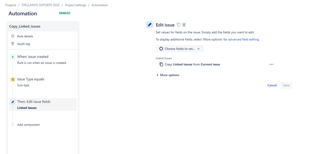

June 27, 2023
Hi @Marco Brundel
Here it is:
Captura de pantalla 2023-06-26 125835.pngCaptura de pantalla 2023-06-26 145915.png
BR
Jose
Marco Brundel
June 27, 2023
I see you use 'copy linked issues from current issue'. If you change this to 'copy linked issues from parent issue' does it work?
regards, Marco
June 28, 2023
Yes!!! It works!!!!
