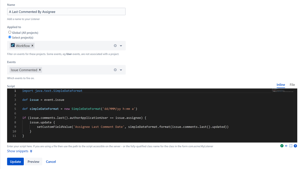

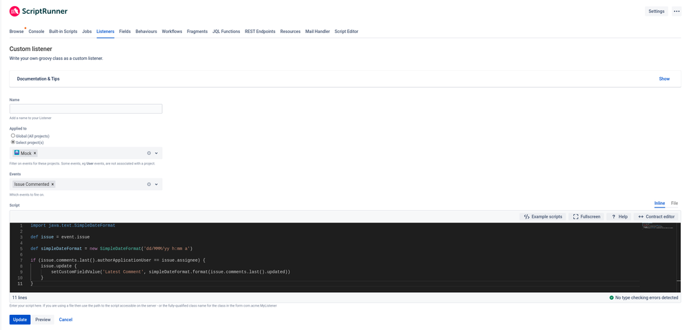

Below is a screenshot of the Listener configuration:-
I hope this helps to solve your question. :-)

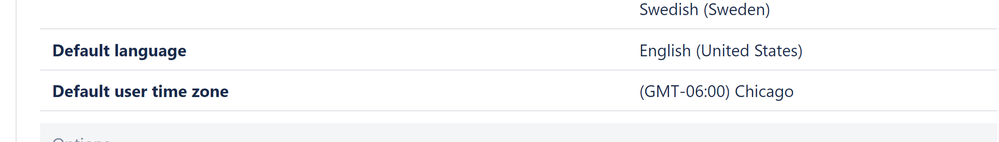

In the "General Configuration", its showing below.

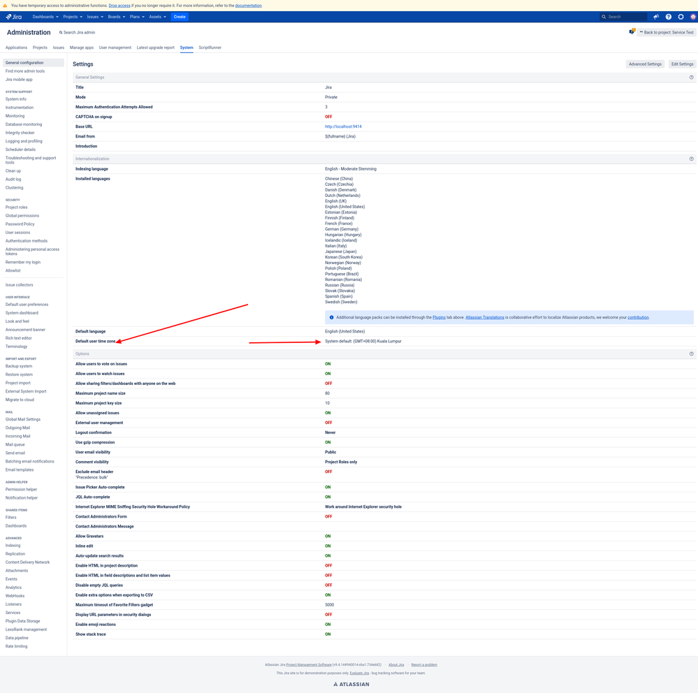

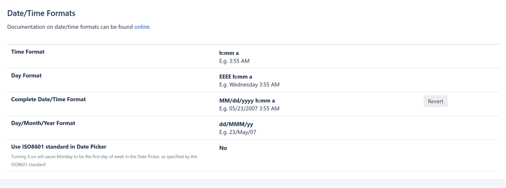

Please provide a screenshot of the time configuration on your Jira instance as shown in the screenshot below:-
This is to confirm what timezone in set on your Jira instance.

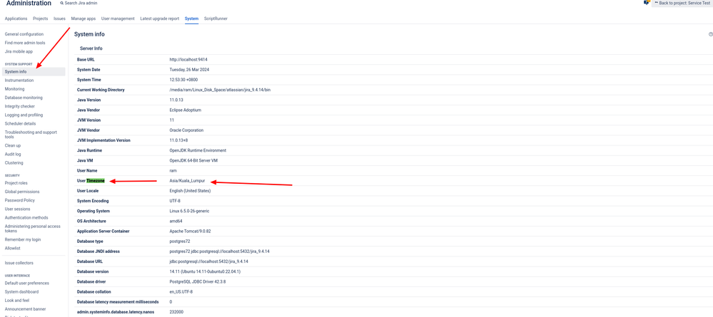

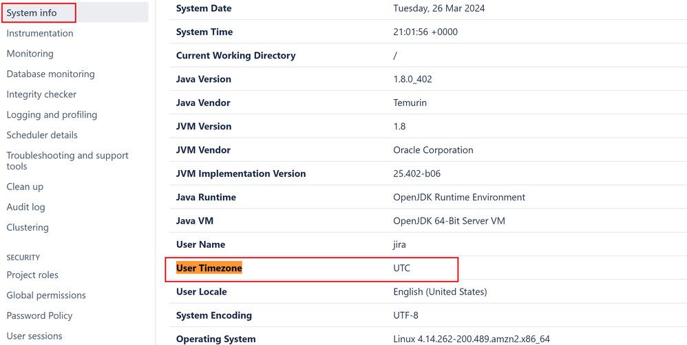

Also, go to Jira Administration > System > System Info  and show the timezone's configured as shown in the screenshots below:-
To override this configuration, please follow the steps provided in this Atlassian KB documentation.

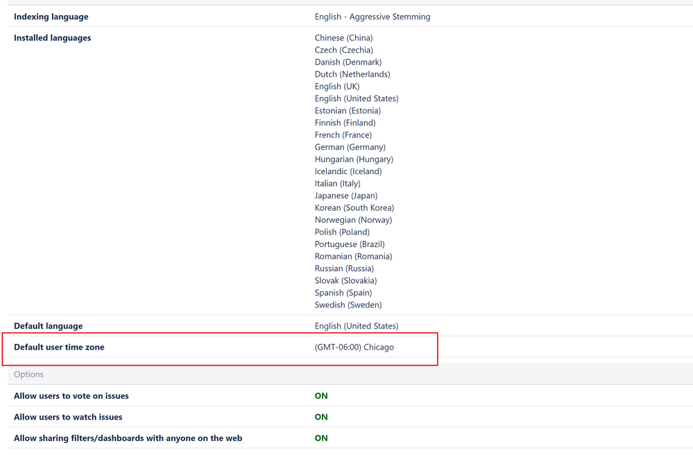

jira_admin_cu
March 26, 2024

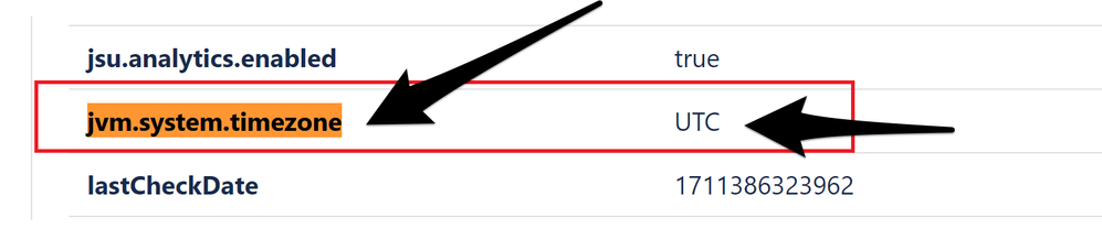

Thank you for your detailed explanation @Ram Kumar Aravindakshan _Adaptavist_
Please find the attached screenshots for your reference as your above comment.
March 28, 2024
Hi @jira_admin_cu

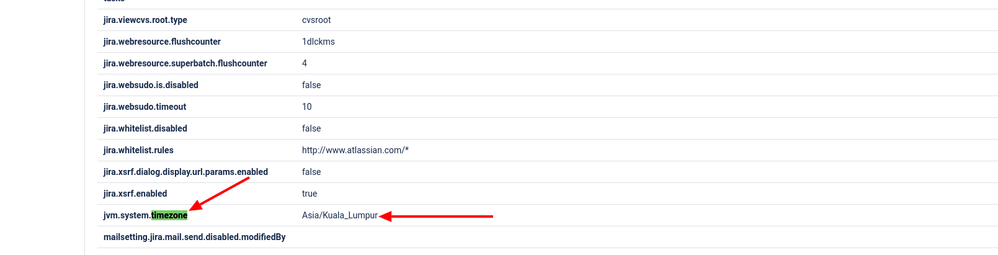

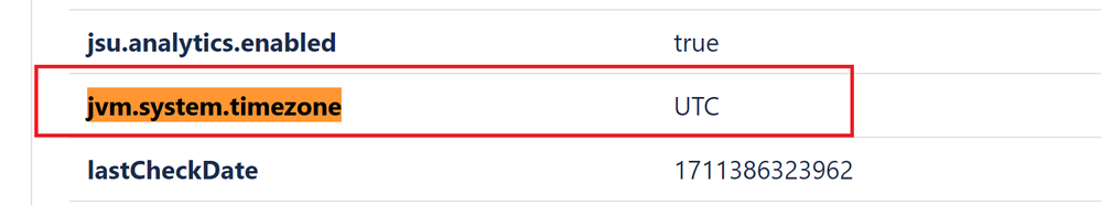

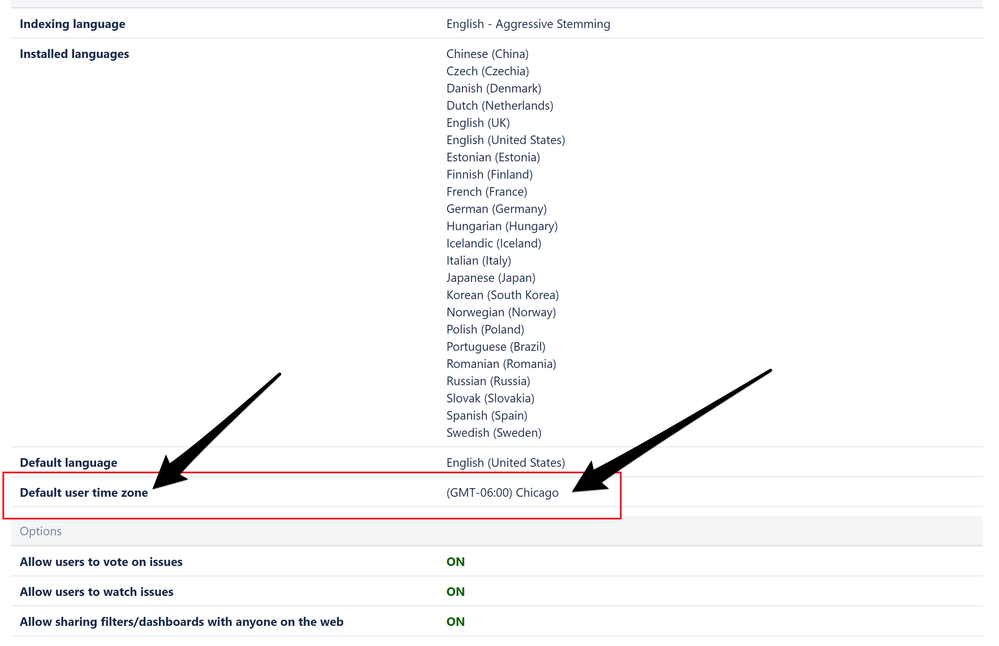

If you view the screenshot that was shared in your last comment, there are 2 different time zones set.
In the Default User timezone is set to GMT-6 i.e. UTC-6 as shown in the screenshot you shared:-
Whereas the User Time Zone and jvm.system.timezone are set to UTC / GMT and not UTC-6 / GMT-6 as shown in the screenshots below:-
This clearly indicates that the clock configuration in your Jira environment is out of sync which is causing the result you are getting.
To resolve this, you must update the User Time Zone and java.system.timezone to UTC-6.
Please refer to this Atlassian KB document for more information on how to update the time.
