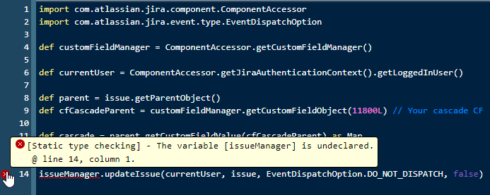

Thank you very much for your script, it works like a charm. It does show an error though (please have a look at the attached screenshot). Furthermore it throws an error in the log, every time it is executed. Can you think of a way to prevent that from happening?
2018-06-14 09:12:10,681 ERROR [workflow.ScriptWorkflowFunction]: ************************************************************************************* 2018-06-14 09:12:10,681 ERROR [workflow.ScriptWorkflowFunction]: Script function failed on issue: null, actionId: 1, file: <inline script> groovy.lang.MissingPropertyException: No such property: issueManager for class: Script140 at Script140.run(Script140.groovy:14)

Hello, add right after def customFieldManager
def issueManager = ComponentAccessor.getIssueManager()
