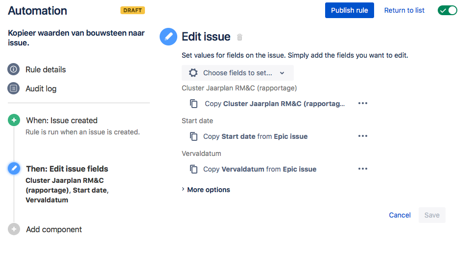

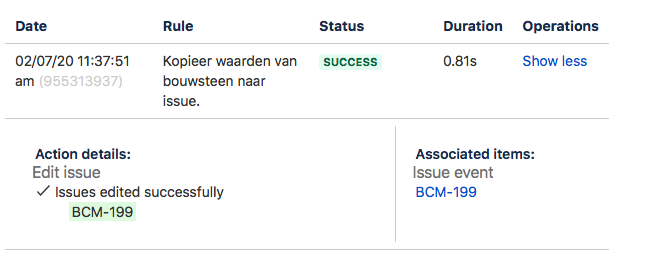

There are couple fields in child issues that mostly match the parent issue, but sometimes need to be changed. For easy implementing I would like to copy the Epic values upon creating the child issue. I tried using 'Automation' in different configurations but I can't get it to work. It say's 'Succes' but the fields in the new issue don't reflect the fields in the Epic.
This is the current exported rule:
Thank you for taking your time to help me with this issue!

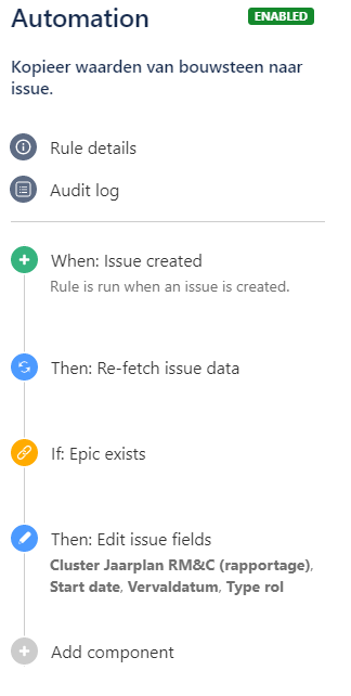

An update: another community member saw a similar issue with the edit/copy not working.  They solved that by adding a re-fetch action to solve a potential timing problem where the created issue does not yet have the parent link.
So, your updated rule would be:
  • Trigger: issue created
  • Action: re-fetch the issue
  • Condition: confirm the issue has an epic link (not empty)
  • Action: edit issue to copy the parent epic's fields
Like • # people like this
Huey van Zijl
July 7, 2020
Hi @Bill Sheboy ,
Thank you so much for helping me, your advice did the trick! For anyone searching the forums here is my implemented solution:
Tip: be sure to configure the last step 'Then: Edit issue fields" correctly by telling it to copy from epic. :)

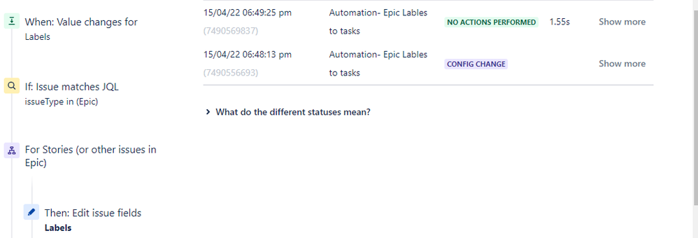

I have this automation running and it works when an issue is created; however is there a way to get this to trigger when the field value changes on the Epic and it copies the the new field value to all child issues (tasks/stories)?Screen Shot 2021-12-15 at 12.05.16 PM.png

The rule you show is triggered on a field value change, not issue create.  Are you certain that triggers on create as you noted?
Next, you should be able to detect the change in the epic and then copy that down to its child issues.  For example:
  • trigger: field changes
  • condition: issue type is epic
  • branch: on the epic's child issues
    • action: edit the field, copying from the trigger issue
Please also see the template library for other example rules like this: https://www.atlassian.com/software/jira/automation-template-library#/
Kind regards,
Bill
