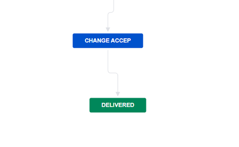

1) Need to write a "post function" on "Delivered" status (subtask), to copy the fields from "subtask" issue to parent issue.

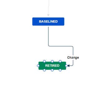

For this it should satisfy (issue type Parent issue is story and status should be in "baselined")
Parent issue wrkflw

Yes Alex, i have  JSU, JMWE and scriptrunner
Using Datacenter 8.20.
Subtask --     wrkflw   ---     "Change Accep"  to   "Delivered"
Parent issue  wrkflw  ---      "Baselined"    to "Retired"
The below 2 points A)  and B) should be achieved when the status is in "Delivered" (Sub-task)

2nd Condition : the status of sub-task should be "Delivered"
if these 2 conditions satisfies fields values to be copied to "Parent" From "Sub-task"
B)  Also, there is a custom field called "Retired" (it is a drop down with options "true" or false") in the Sub-task issue.
Once  "A" (Above copying field values) are done.
 the value of "Retired" Custom field in the sub-task should be checked.
1st Condition --  If "true"  then automatically status should move from  "Baselined" to "Retired"    (This is in Parent issue transition)
