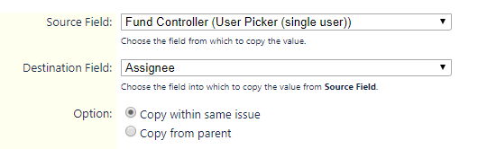

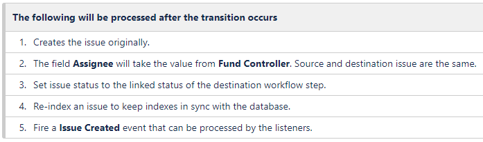

The above image shows how I have set up the post function. This works for every other transition except the initial create transition. Below is a list of all the post-functions on said transition.
Jira issue2.PNGAny ideas on any possible fixes?

Hi @gvigurs
Move "The field Assignee...." post function to first position and try again.
Ravi
gvigurs
June 27, 2019
This worked! Thank you for the quick response, I was silly and didn't realize that the position of the post-functions in the list made an impact!
