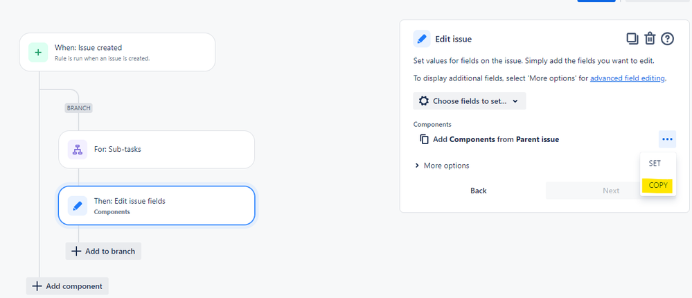

Hi,
When a sub-task is created, components should be copied from the parent issue.
I have created the above rule but nothing happens (the audit log says "No actions performed") and I could use some assistance.
Thank you!

Hello @Frida Gustafsson
have a look at similar post here: https://community.atlassian.com/t5/Jira-questions/Copying-the-target-parent-s-component-field-to-a-subtask-when/qaq-p/2294219
There is a "timing issue" mentioned.
Try adding "re-fetch data action".

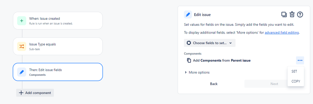

I've also tried the following with no success: jira components 2.png
