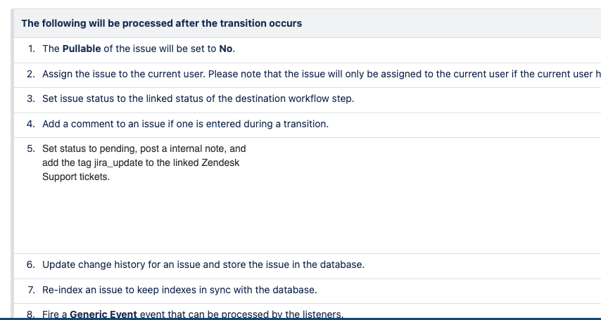

This is a software project. Here is where we put the post functions.

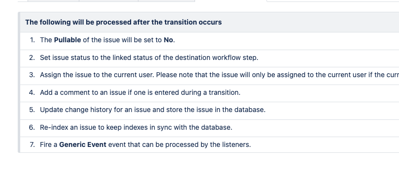

Here is an example of the before and after.
We added #5.

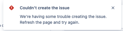

When we try to create an issue. This is what we get:
Is this possibly a permissions issue?

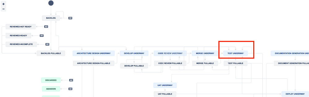

Is the workflow associated to just the one issue type in the workflow scheme?
Can you show us the Validators and post functions for the Create transition?
Correct. This is just associated to one issue type.
Where would I find the validators/post functions for the create transition?
The Create transition is the arrow from the gray circle to the Backlog status in the workflow.
I think that is the problem! We don't have that in the workflow.
@Trudy P Claspill Thank you so much. We figured out that in the post functions, "create ticket originially was not #1 which was keeping it from moving forward. From a newbie, thank you!
