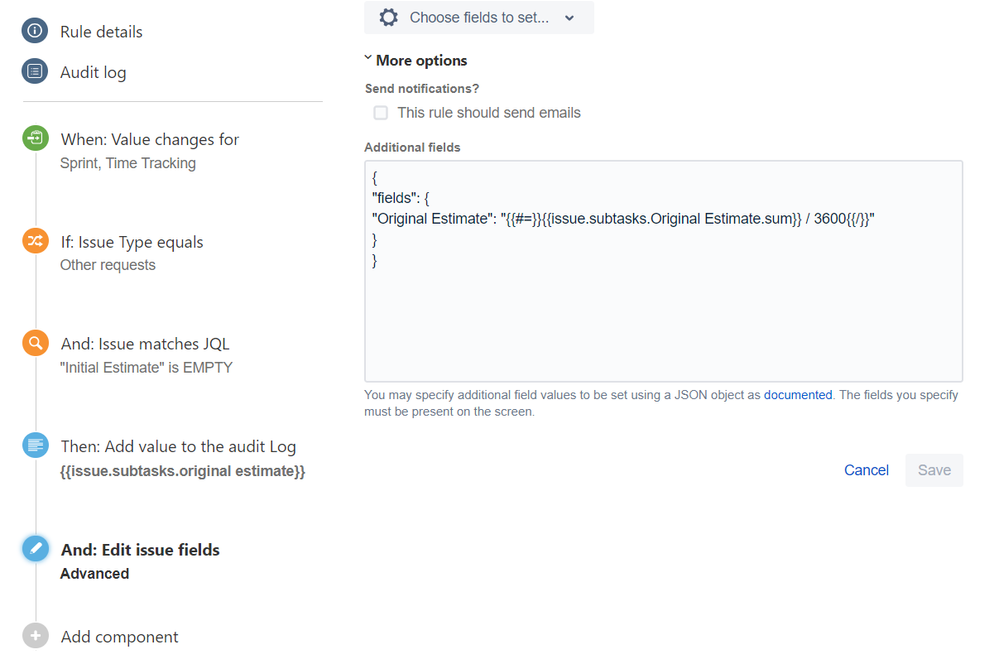

I need create an automation that will copy Remaining Estimate's value into "Original Estimate" Field (Epic Sum Up type)

Please find attached the automation that gives error :
Edit issue
No fields or field values to edit for issues (could be due to some field values not existing in a given project):
CAS-55832

Hello @Demo Test
Can you explain to us the problem you are trying to solve by overwriting an Original Estimate with Remaining Estimate?
If you do this you will not be able to report on how much progress has been made in comparison to the original estimate.

Is the Original Estimate field on the View/edit screen for the issue that triggered; the "Other requests" type issue?

Yes, it is on the View/edit screen
