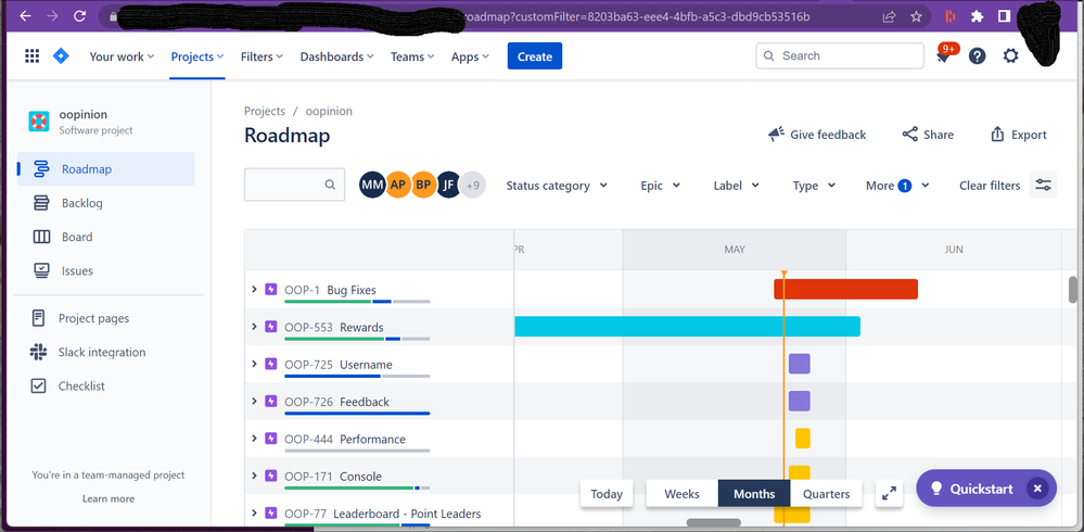

2) Can you help me with the distinction between team and company? A groups of consultants form a team that have activity that I interact with on their board that lives in the consulting company's Jira instance.

#2 - the project type is shown at the bottom of the navigation panel on the left. From your image, that says "team-managed".
There is a cloud-to-cloud migration tool that is currently in Beta release, but it does not support Team Managed projects per this documentation.
The same documentation talks about migrating projects from Cloud to a self-hosted Data Center instance and then to another Cloud instance. But again, Team Managed projects are not supported.
The last method in that documentation is to using a CSV export of the data and CSV import to add it to the destination system. This brings across only issue data, not boards or filters or roadmaps. Boards, Filters, and roadmaps would have to be recreated as would Workflows and custom fields. This method also doesn't bring across the history of the issues, so you would be getting only current state information.
CSV export doesn't require admin access on the source system. You use the Advanced Issue Search screen to get a list of all the issues you want and use the Export option on that same screen.
You would need to create the project on your system to receive the data, recreating the workflow and custom fields that are needed.
You may have to make changes in the exported data so that values for users and selection lists and statuses are an exact match for the values in your system.
Another limitation with CSV import specifically for Team Managed projects is you can connect child issues to Epics as part of the import process. That would have to be done manually after the import completes.
And another limitation is that you can import no more than 250 issues at one time with CSV import.
