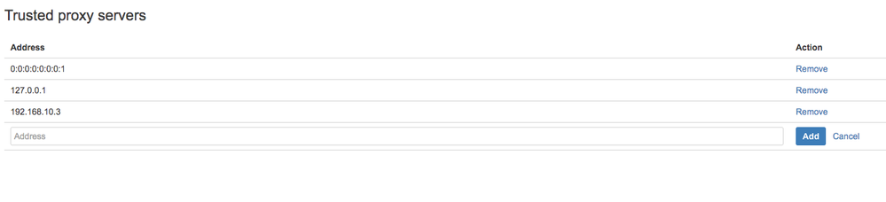

Did you add the IPv6 address to Trusted proxy servers as well (0:0:0:0:0:0:0:1)?
Hi Bruno,
Sorry for the late reply.
See my trusted servers below.
It's being hard to figure out the problem.
Many thank you for your help.
Cheers,
Rui Rodrigues.
