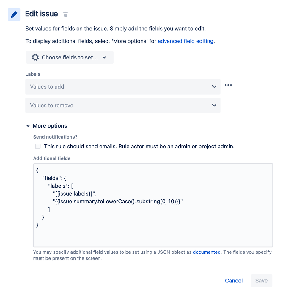

Setting labels with Automation is not as straight-forward as one might want, but ultimately not too bad. I'll assume that you already got your trigger set up and are just looking for a way to add the label. Here's the what that would look like:
The important thing to note here, is that you'll need to include the current labels with this line:
 "{{issue.labels}}",
Of course, instead of using a smart value to grab part of the summary, you'll want to get your custom field.
Hope that helps,
 Oliver

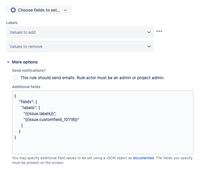

I forgot one small piece to this: the text field in use has spaces in between the name and I need to convert those to underscores to be accepted in a label.
Below is the code I'm actively using without success:
I sincerely appreciate all of the help! I'm just a bit puzzled on this one.

Hi @Jay Dubinsky -- Welcome to the Atlassian Community!
Two things of note:
Please try the replace() function to substitute your spaces for underscores: https://support.atlassian.com/cloud-automation/docs/jira-smart-values-text-fields/#replace-String-target--String-replacement-
And, when using the edit issue action, either select the field (from the dropdown) and enter your smart value expression, or use the advanced edit with JSON.  Do not try to use both for the same field, Labels.
Kind regards,
Bill
