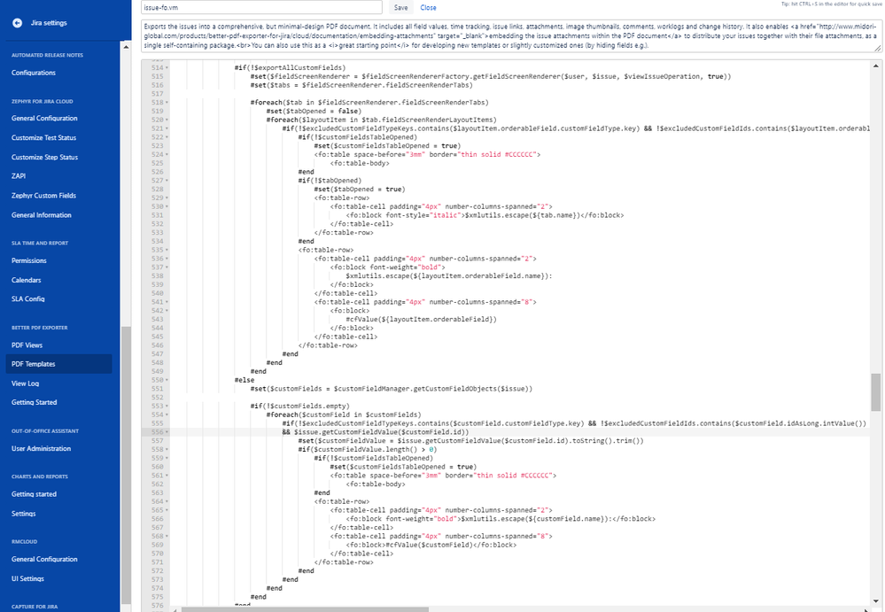

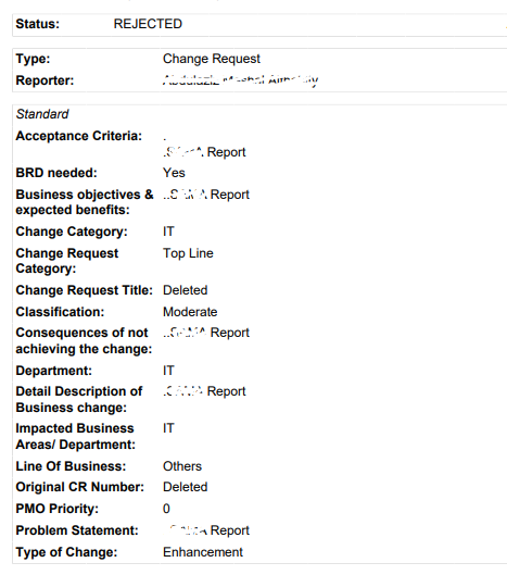

Using Better PDF exporter for JIRA plugin, facing below issues
1. Printing all custom fields
2. Printing all custom fields in ascending order.
I thought of editing the PDF template but I did not get it.
1. PDF Template Code
2. Output of PDF form
How to achieve below points
1. To print only selected custom fields in lie of printing all custom fields
2. Printing in required order.
Thanks

I have gone through the PDF template Code(Issue-fo.vm) to edit exportAllCustomFields ForLoop but i did not get it.
I just wanna edit the vm code to get output like below in a PDF form.
Consider i have 10 custom fields but i wanna print only below fields.
Custom field 01 : Value of Custom Field 01
Custom field 02 : Value of Custom Field 02
Custom field 03 : Value of Custom Field 03
Custom field 09 : Value of Custom Field 09
Custom field 07 : Value of Custom Field 07
Thanks
