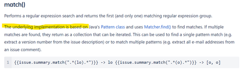

Please also note, the documentation states:
https://support.atlassian.com/cloud-automation/docs/jira-smart-values-text-fields/#match--
Note that "is based on" as it does not specifically indicate what does / does not work for regular expression syntax.  Several other community posts have found regular expressions which work elsewhere do not work the same in automation rules.
I encourage starting with the simplest expression that can possibly work, testing, and only then incrementally add more to handle edge cases, testing as you proceed.
