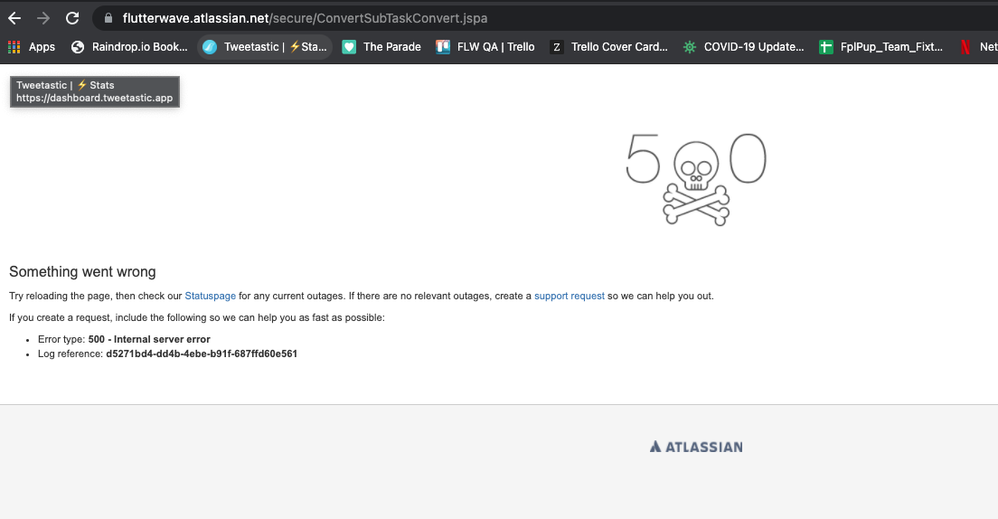

I tried converting a sub-task to issue this morning and there was a failure. Got here because of the way the process to report issues like this is routed.
See response page:

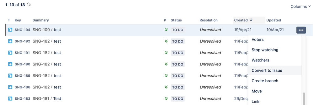

I tried to replicate it here on my test site and it only happens on a team-managed project when using the option directly from the Search issues page.

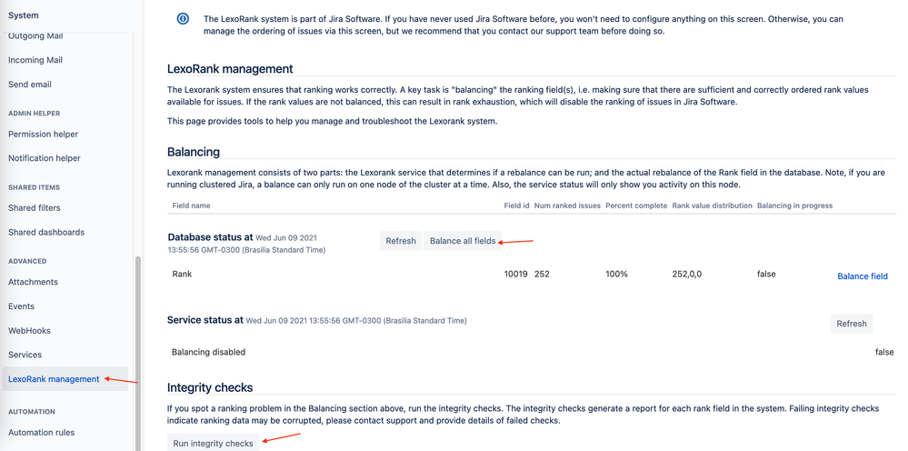

There is one last test to do that may help fix the issue or it may also return some error that will help us identify what is causing it.
It’s necessary to be a Jira administrator to run the steps below:
Go to Cog icon > System > LexoRank Management.
On this page, there is an option to Balance all fields and the Integrity checks that will show PASSED or FAILED. If it fails, it will show errors that will help us.
If everything goes fine, then please, test converting an issue again. If still doesn’t work, then it will be necessary to create a ticket so we can access the site to replicate the issue.

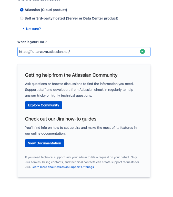

This support ticket link brought me to the Community. I could not submit a ticket, because the Explore Community and View Documentation options were the options displayed after I provided my URL.
Callum Carlile _Automation Consultants_
June 7, 2021
@Chibuzor Obilom Based on your screenshot, it looks like you're on the Free plan of Jira, and therefore cannot raise a support ticket through my above link. I have raised your issue with someone in the Atlassian team, so hopefully someone will be in touch with you soon!
