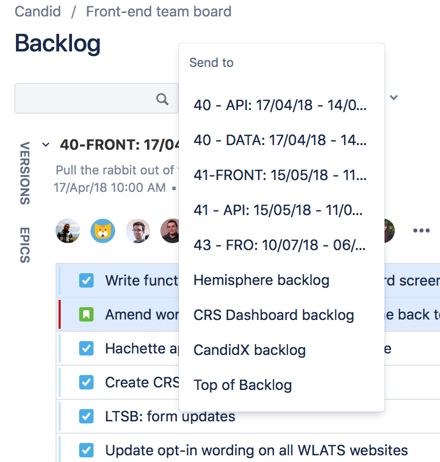

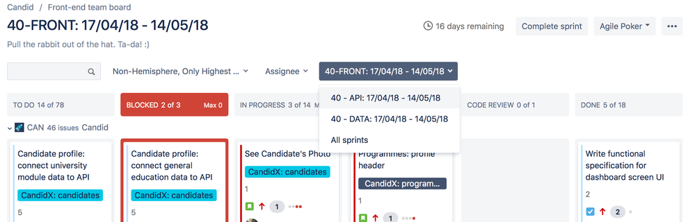

Carlton McFarlane
April 20, 2018
Hi @Andy Heinzer
Sorry for the delayed response.
We have three sprints running at once - one for each of our teams -> UI, API and data. We have a "main" board which is the one we started with, and then there is a separate front-end board, which duplicates it. They use the same project filters in board setting and are both scrum boards.
From either of the boards, we have the options to change which sprint we see on the board.
I have noticed that, in backlog view, if I am on the front-end board, I have the right-click contextual menu. But not on the "main" board.
Is there a specific setting you've found that might cause this?

Andy Heinzer
January 2, 2019
Hi Carlton,
Sorry for the missed response.   I can't seem to quite recreate your screenshots in my Jira Cloud instance.  I'm not sure if this is because of changes to Jira Cloud since your previous post, or perhaps there is something different in your Cloud site than mine.
In your active sprints view, I don't currently see a quick filter to show the specific sprint.  I am curious if maybe this is something added by the Agile Poker plugin you appear to be running or some other plugin to your site.
However I also can't recreate the missing "Send to sprint" option in your 2nd backlog screenshot. I went as far as to create 11 active sprints in the same board to see if there maybe was some limit to displaying these.   But in my test, it appears to work correctly.
Hence I think it might be best to create a support request with our Cloud support team to further investigate this behavior.   It does not appear to be what I would expect to see here, so maybe there is something wrong here.
I would be happy to create this support request on your behalf, however I see that your account appears to have more than one Cloud site associated with your email address.  So I'm not sure what Cloud URL you are using when you see this problem.  However if you go to https://support.atlassian.com select technical problem, and enter your Jira Cloud URL, you should be able to create a support request provided that you are the technical contact for that Cloud site.  If you have any problems with doing this please let me know.
