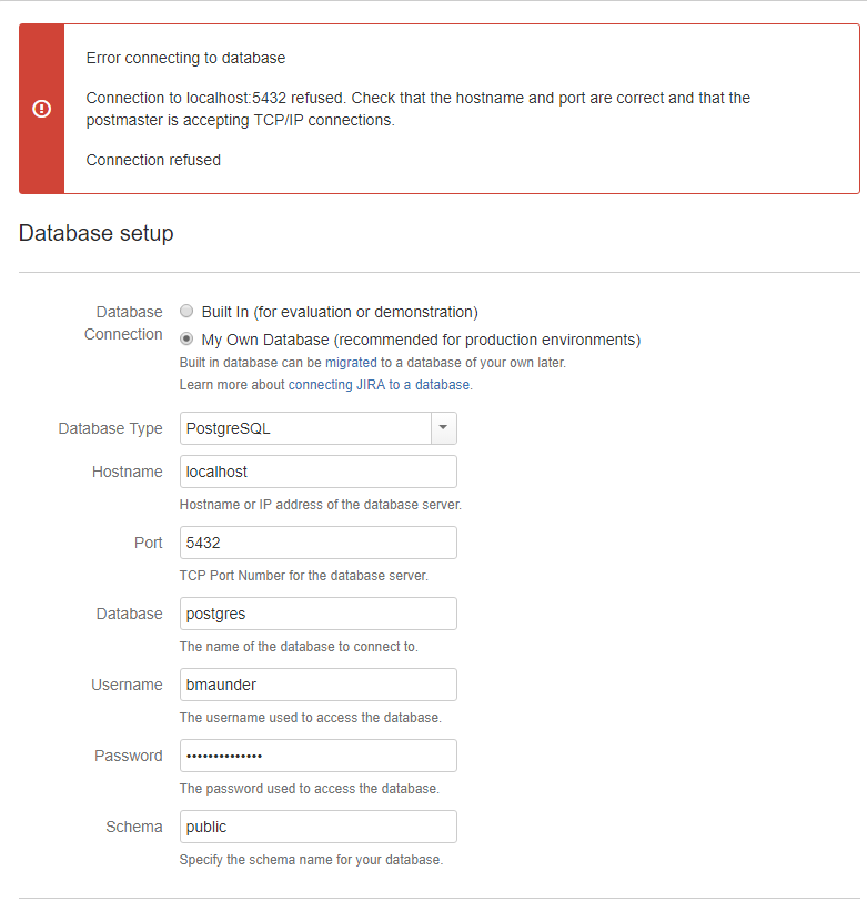

David Ashwell
November 10, 2017
i tried the LOCALHOST, but no go.. check out the reply that i sent to NIC.. jira.PNG
Andy Heinzer
November 10, 2017
Took another look at your config, I think I see a problem here:
# - Connection Settings -
#listen_addresses = 'localhost' # what IP address(es) to listen on;
127.0.0.1,10.100.1.109 # comma-separated list of addresses;
* # defaults to 'localhost'; use '*' for all
# (change requires restart)
port = 5432 # (change requires restart)
You will need to uncomment a 'listen_addresses' entry or provide some other 'listen_addresses' entry in this config in order to make sure that postgres is actually listening on that address.  I think this can look like this:
port = 5432
You will need to save that file change and restart postgres to make sure this takes effect.  Try that and see if you can connect with either the name 'localhost' (no quotes) or the IP address 127.0.0.1

David Ashwell
November 10, 2017
SOoo.... i finally got it Connected..
what i did was this ...
I edited the pg_hba.conf file to point the server to its local address..
# hostnossl DATABASE USER ADDRESS METHOD [OPTIONS]
local all all trust
host all all 127.0.0.1/32 trust
host all all 0.0.0.0/0 trust
hostnossl all all 0.0.0.0/0 trust
I had edited the postgresql.conf file... but once i deleted everything back to normal, and restarted the postgres service, i was able to connect to the database!
** NOTE** once you edit either one of these files, you must restart the service.. Even though i was doing that after each change it still did not work.. So as a test i went into sudo -i -u postgres, got the postgres@<servername>:~$ prompt... then did a psql.. came up with an error..
"psql: could not connect to server: No such file or directory
Is the server running locally and accepting
connections on Unix domain socket "/var/run/postgresql/.s.PGSQL.5432"?"
thats when I deleted everything that i did in the postgresql.conf file and restarted the service again..
then again one more time for good measure.. and boom Connected.. **
