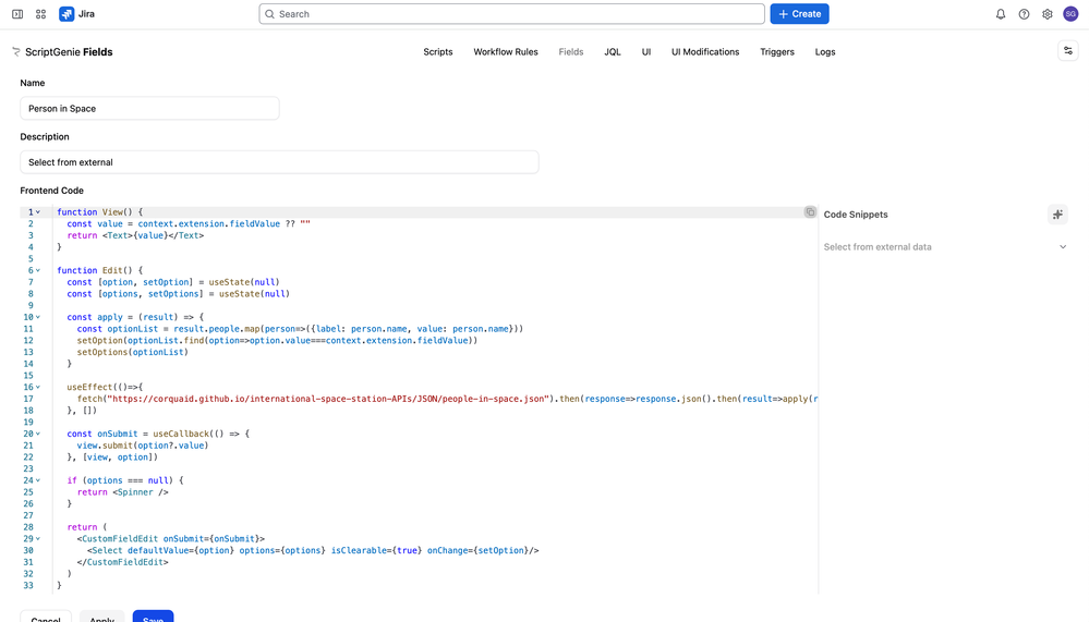

Hi @WG
If you want to go with option 1, you can do this with ScriptGenie (full disclosure: I am the developer). If you want to go with option 2 you can still (re)use parts of the code in the ScriptGenie example below:
