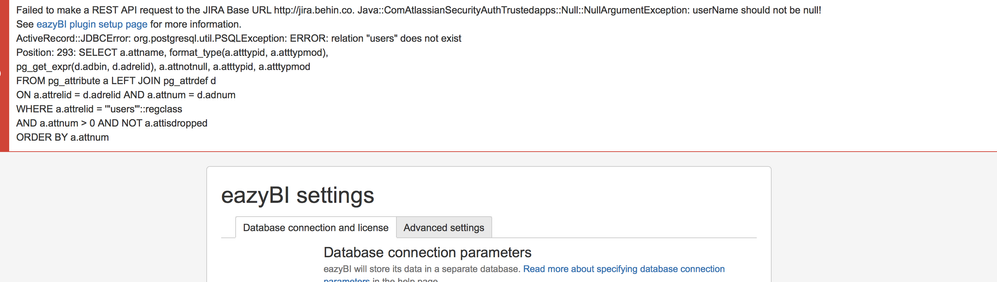

Postgress:

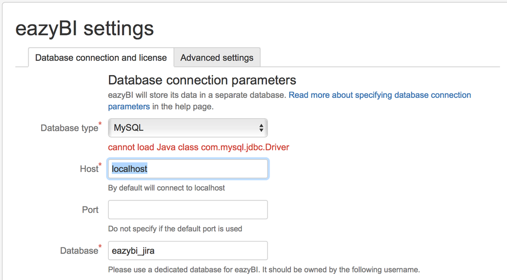

MySQL:

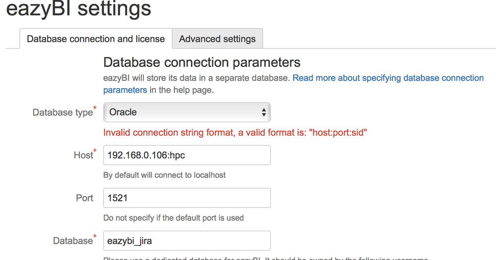

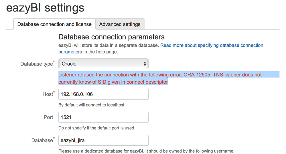

Oracle:
Screen Shot 1396-08-18 at 16.12.39.pngScreen Shot 1396-08-18 at 16.12.17.png

Regarding MySQL - MySQL JDBC driver isn't included into Jira or eazyBI because of licensing requirements. Please see https://confluence.atlassian.com/adminjiraserver071/connecting-jira-applications-to-mysql-802592179.html#ConnectingJIRAapplicationstoMySQL-jdbcdriver2.CopytheMySQLJDBCdrivertoyourapplicationserver how to get it.
Regarding Oracle - usually, eazybi_jira is just username, not database name. In field 'Database' you must provide database name.
Regarding PostgreSQL - it seems that there was an error during eazyBI initialization. Could you please specify used PostgreSQL version?

- For MySQL I do same and reset JIRA server, But nothing happen and I see that message again.
- For Oracle I create a user and Oracle create an schema Automatically. I consider schema as database name. I think the problem here about connection string properties. EasyBi didn't provide right field according to oracle database connection string.
- For Postgres I use version 10

In case of Oracle, schema name is almost the same as the user. As database name, you need to specify SID or Service Name. For example, if you have the following TNS record - (DESCRIPTION=(ADDRESS_LIST=(ADDRESS=(PROTOCOL=tcp)(HOST=localhost)(PORT=1521)))(CONNECT_DATA=(SERVICE_NAME=ORCL))), then in the field 'Database name' you need to enter ORCL.
About MySQL and Postgres - could you please send listing of <JIRA installation directory>/lib/ directory files and eazyBI log files (https://docs.eazybi.com/display/EAZYBIJIRA/Troubleshooting#Troubleshooting-eazyBIlogfiles) to support@eazybi.com ?

I change database name with SID name and It worked for me.
I think you should update your documentation, change field name or provide some help for users like me who face with this situation.

Some extra permission like create session, create type, create procedure is needed for connection to database in my case.

About extra permissions - it's mentioned in our documentation https://docs.eazybi.com/display/EAZYBIJIRA/Installation+and+setup#Installationandsetup-Oracle. You need to execute the following statement:
GRANT CONNECT, RESOURCE TO eazybi_jira;
Those two roles will include all needed permissions.
