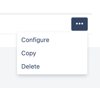

I created a KANBAN Board with a filter that only show specific epics. I did configure my dashboard (added swimlanes, columns, quick filters). There was one JIRA feature that asked me if I wanted to use the new "backlog". Today, i wanted to change the columns of my board and I have no access to the configure board screen.
I decided that I was going to copy it, thinking that I maybe corrupted it with this backlog feature. Now I have a Copy Board that is also impossible to configure and therefor I cannot delete it.

If you want to delete a board you created, go to the Boards menu and select View All Boards. Find the board you created in that list. Click on the three dots to the far right of that board in the list. Select Delete. If you created the board and are still an Administrator for the board, you should be able to delete it.
That doesn't delete the filter used by the board. That has to be deleted separately from the Issues > Manage Filters screen.
