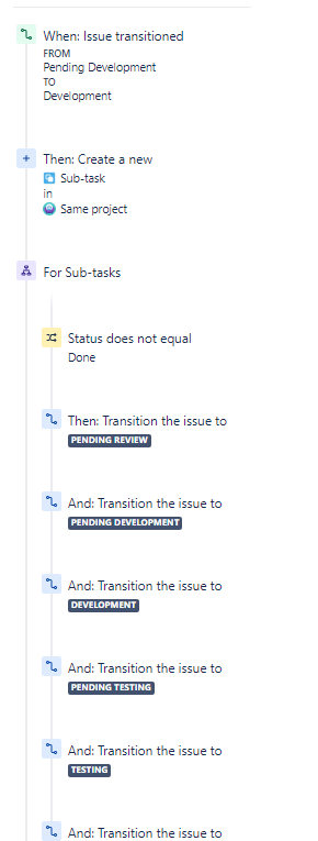

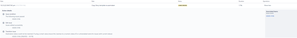

my automation has been succses to transation to other status , but i dont know why on audit log my automation make some error , how i solve that .
attached screenshoot some error

Hi @Blair
Would you please explain the problem you are trying to solve with that rule?  Knowing that may help the community to offer suggestions.
As your rule is shown...I would expect completely unpredictable behavior regarding sub-task status transitions.  The reason is that branches execute for each issue in parallel and asynchronously.  And your rule appears to be transitioning the sub-tasks repeatedly...so subject to rule performance and timing, it may be unclear what the final status will be.

Without knowing the problem you are trying to solve, I am unclear what you are asking regarding a recommendation.
The purpose of the rule image you posted is unclear to me, as it appears to create a subtask, and then repeatedly transition all subtasks to different status values in an unpredictable manner.  I cannot think of any reason to do that.

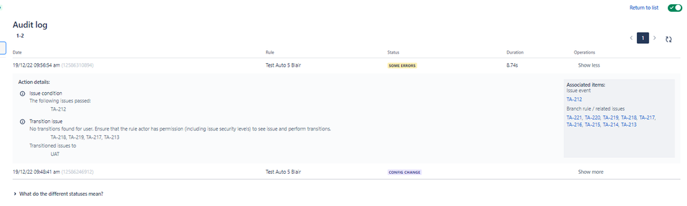

If you click on the show more in the right column the log should provide more info on what went wrong.
Example:
Will be easier to help you out

Hi Frederik,
Attached , can you help me to explain that ? thankyouu very muchScreenshot_18.png
