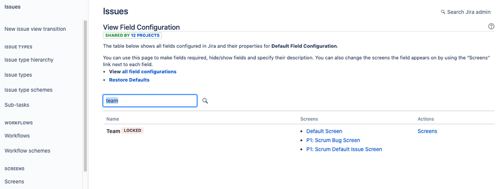

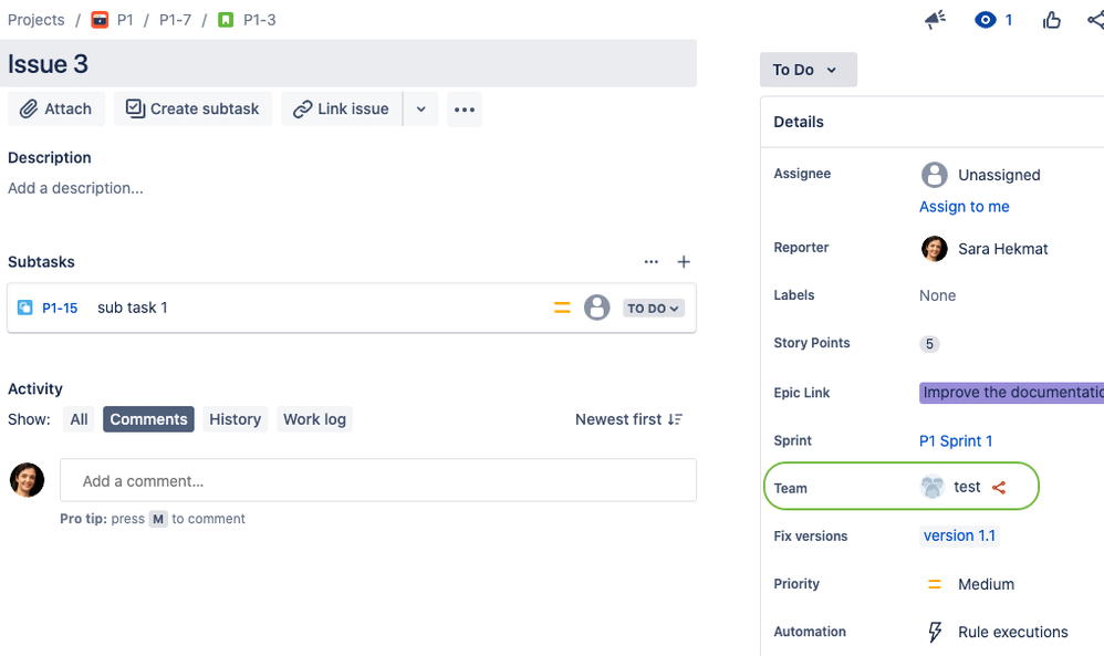

It seems you have JSW premium license, ideally, you should be able to use the Advanced Roadmaps Team field instead of assigning specific components to the issues.
The Team field is a custom field in JSW premium that can be added to your project issue screens.
Third-level issues (higher than epic) are used to track the work across different teams, for instance, if you have some initiative that is worked on by both the ENG and REP teams, then you can create a high-level (above epic) issue for it and create the teams epic as its children.
Regards,
Sara
Screen Shot 2023-02-13 at 10.47.24 am.pngScreen Shot 2023-02-13 at 10.48.39 am.png
