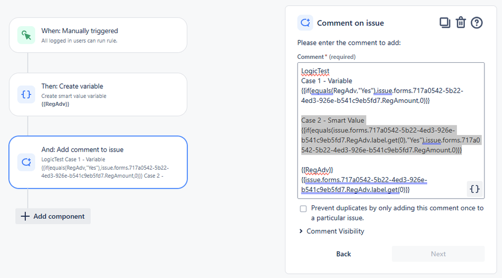

I have an automation that I'm using form data to drive an automation:
I've tried to equivalent approaches, but get different results and I'm not sure why.
LogicTests
Case 1 - Variable
RedAdv = {{issue.forms.717a0542-5b22-4ed3-926e-b541c9eb5fd7.RegAdv.label.get(0)}}
{{if(equals(RegAdv,"Yes"),issue.forms.717a0542-5b22-4ed3-926e-b541c9eb5fd7.RegAmount,0)}}
It returns the value expected
Case 2 - Smart Value
{{if(equals(issue.forms.717a0542-5b22-4ed3-926e-b541c9eb5fd7.RegAdv.label.get(0),"Yes"),issue.forms.717a0542-5b22-4ed3-926e-b541c9eb5fd7.RegAmount,0)}}
It fails and returns 0
{{RegAdv}} and {{issue.forms.717a0542-5b22-4ed3-926e-b541c9eb5fd7.RegAdv.label.get(0)}} return the same value so the context seems the same.
Any idea why it only works with a variable and not a smart value?

Ludwig Einicke
August 18, 2026
Hi @Andy Chlup, hi @Bill Sheboy
After having my share of "fun" with automations and variables I can confirm (or at least strongly infer) that it is, indeed, a scope issue.
Smart values stop working as soon as you bury them inside a function. Your cases actually function as a good example for where the border lies:
Case 1: (working)
The smart object gets read and interpreted correctly, as it isn't "layered" into anything else.
Case 2: (blurred lines)
 The Variable "RegAdv" is in-scope, because it was defined inside the same automation and gets read correctly because of that. The Smart Value gets read correctly aswell (I am actually positively surprised this works). This might be a special case as I have encountered functions where "the smart value being inside of a function" will already cause the scope to narrow down and deny correct interpretation and/or issuefield lookups of the smart value.
I have noticed that this is actually improving over time. Atlassian seems to be doing some work in the background to extend smartvalue functionality inside functions.
Case 3: (not working)
At some point the smart value gets nested "too deep" to get correct interpretation and/or access to issuefield lookups:
Where this exact point is seems to vary across functions (see above). Here it is a clear case of: The "equals" function tries to look up a variable named "issue.forms[...]", gets confused and stops trying. I personally think that it simply has no way of interpreting the input as smartvalue and will always try to find a variable with the same name defined inside the automation run first after interpreting it simply as string. I have no way of confirming that though. We can also view it as out of scope because either way, there is no way for the "equals" function to access issuefields for the direct inputs we give it.

For your case (which doesn't need a LookupTable, just to be clear):
Create Variable: RedAdv = {{issue.forms.717a0542-5b22-4ed3-926e-b541c9eb5fd7.RegAdv.label.get(0)}}
Create LookupTable: myTable (see above)
Log action: {{RedAdv}} | {{myTable.get(RedAdv)}}
-- only if needed: Conditional Block: If {{RedAdv}} equals "Yes"
Add Comment to issue: {{myTable.get("Yes")}}
