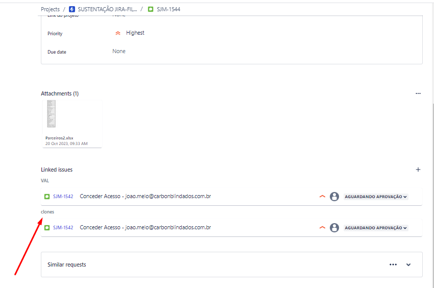

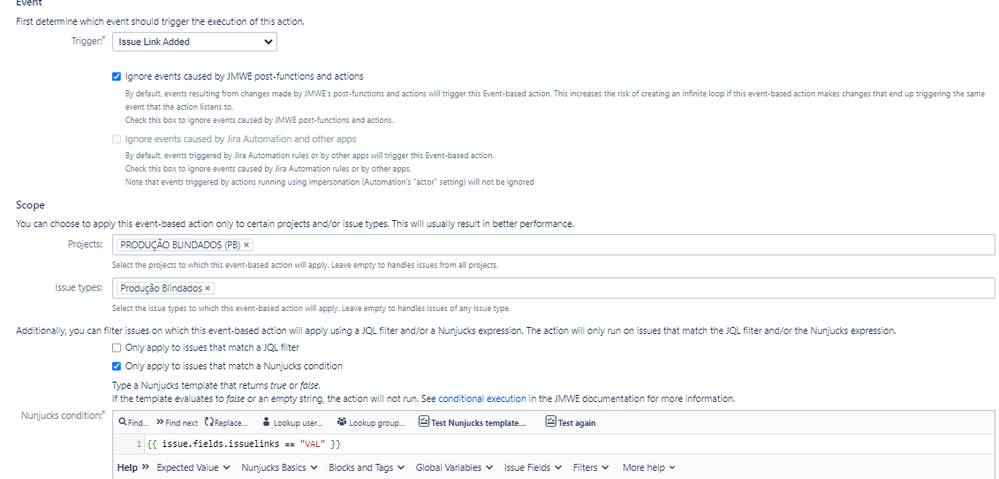

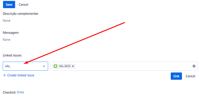

So that's right, I'm making a Pos Function where a condition exists:
Trigger: When an Item is linked.
Pos function: Add a label
Condition: When the link type is: VAL

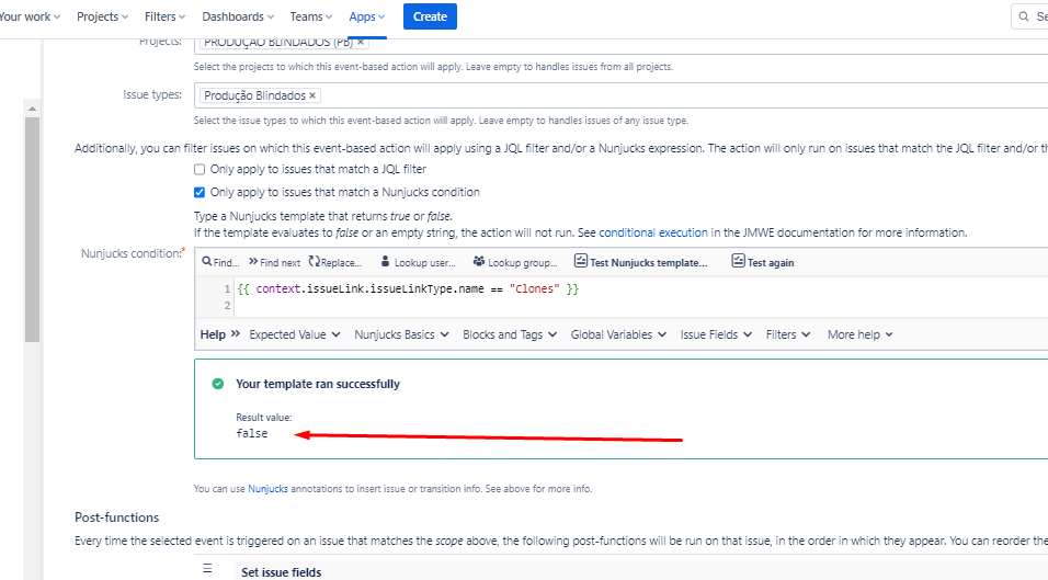

In that case, you're trying to test the link type of the issue link being added, not of any existing issue link. The link being added is available through the context.issueLink variable, as documented on the event based actions documentation. However, only the issue link type is available, not the issue link direction. For example, the "Clones" issue link type has two issue link directions: "clones" and "is cloned by". And users select a link direction, not a link type, in the "link issue" dialog box. So you'll need to figure out what the link type name is on the "Issue Linking" Jira admin page. Then you'll be able to use a condition like:
{{ context.issueLink.issueLinkType.name == "Clones" }}
Henrique Degan
October 20, 2023
Hello, thank you very much for your feedback.
I also tried Context but still nothing:
David Fischer
October 20, 2023
Unfortunately, you cannot "test" the condition in the post function editor, as the context is empty (you are not currently linking an issue). You need to test it by saving the event based actions and linking issues together
