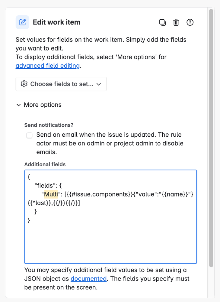

Kseniia Trushnikova
July 8, 2025
@Dd, hm... Is the custom field ID correct? Try to use the name of the field instead.
Here's my rule as reference:
"Multi" is the name of my test multi-select field. The rule runs successfully.
