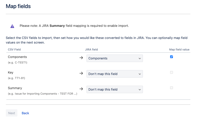

I am having trouble mapping fields using option 1 from this article
https://confluence.atlassian.com/jirakb/how-to-bulk-import-components-into-jira-issues-720418562.html
I have Key and Summary but do not have an option to map them. I attached a screen shot of map fields screen
Does anyone have any ideas on how to help with this?

You don't need to use "Map the field value" for this process for any of the fields.
Where that article says "map the fields" it just means completing the step on the screen you pictured where you select the Jira fields to which your CSV columns are being mapped.
Amanda Busiello
October 31, 2022
what if the field is required?
Trudy P Claspill
October 31, 2022
You have to select a field in the "Jira Field" column (the red box). You don't have to check the box that says "Map field value" (the blue box).Screen Shot 2022-10-31 at 11.41.28 AM.png

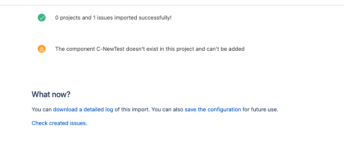

got it, I did this, but an issue was created and not the component. Any thoughts on why? I didn't map anything but component
Amanda Busiello
October 31, 2022

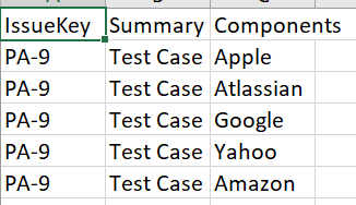

Hi @Amanda Busiello   First you must have JIRA Admin permission and then go to "External System import" .
Create one Test issue in the project in which you want to new Components. Copy that Issue Key and paste in CSV file in " Issue Key' column, copy the summary of that issue and paste in Summary column and add new Components in Components column.
Please find attached screenshots.

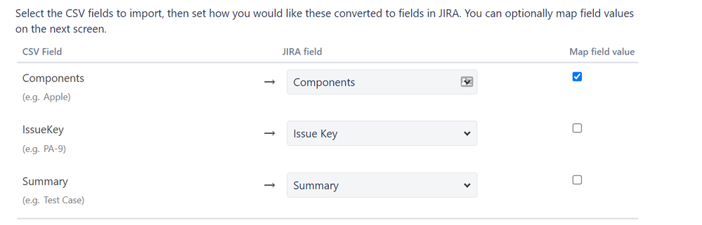

Vikrant Yadav
November 2, 2022
Vikrant Yadav
November 2, 2022

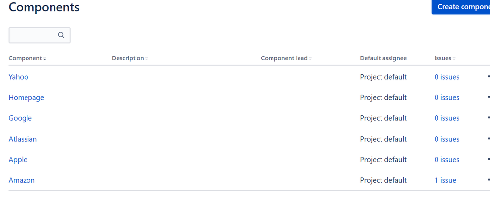

Vikrant Yadav
November 2, 2022
