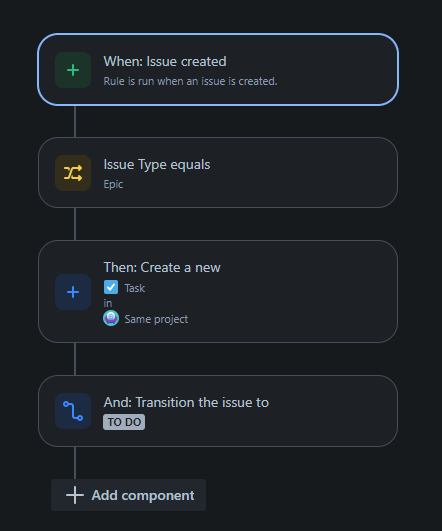

Katie Swanson-Wikelius
February 11, 2024

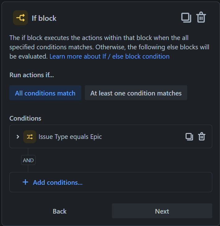

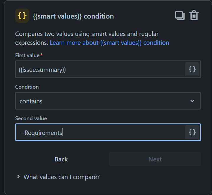

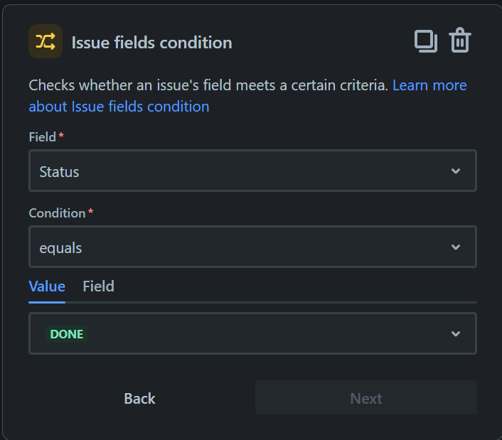

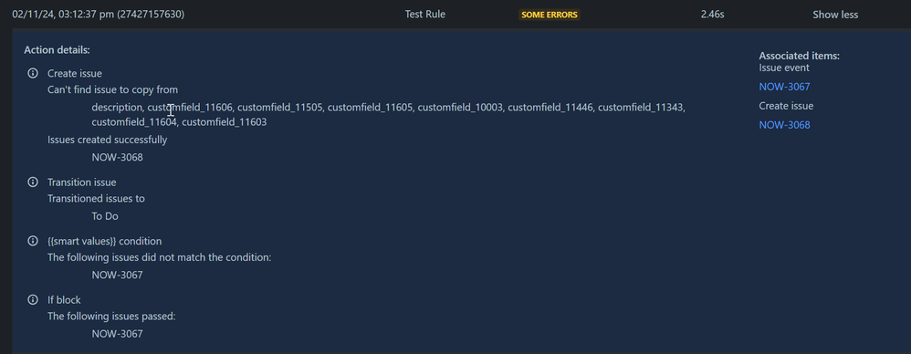

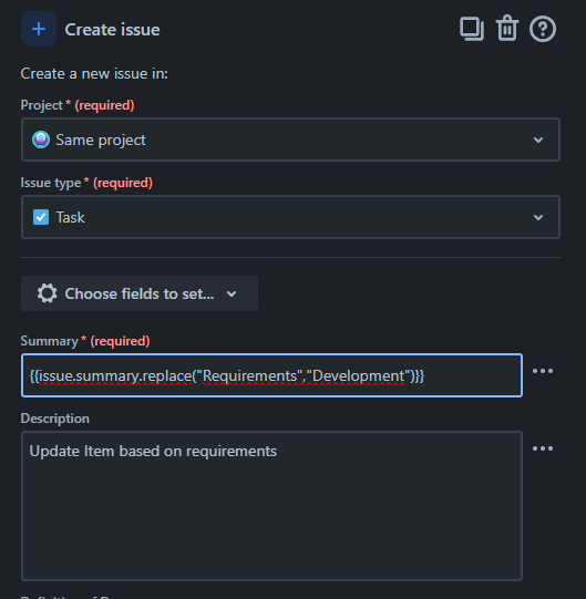

I have been recreating the automation and have it at a place where it's working a bit like I want it to, but I'm running into trouble when I try to create a new task once the first one is "Done" and having it moved to "To Do" with a different Summary.  I've found some smart values that seem to help a bit, but not sure how that will translate with subsequent tasks.

Bill Sheboy
February 11, 2024
Rules trigger when an event happens.  This is why I noted earlier you would need at least 2 different rules: one triggered on issue create, and another on the transition to Done.  I want to confirm you understand that, as rules do not run for a while, stop until some other event happens, and later pickup where the paused.
Please consider splitting your rule into the two things you want to do, triggered on the different events.  Remember to use conditions in the second rule, confirming it is processing the issue you want to use before proceeding.

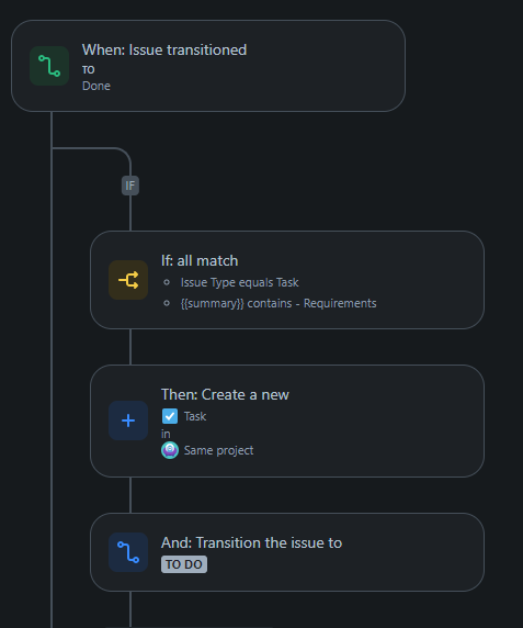

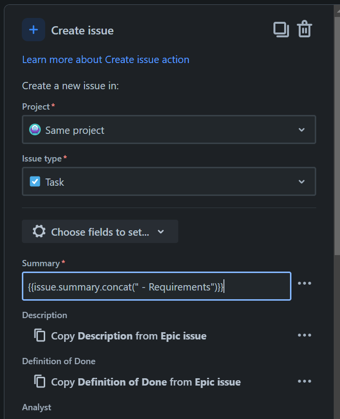

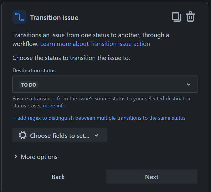

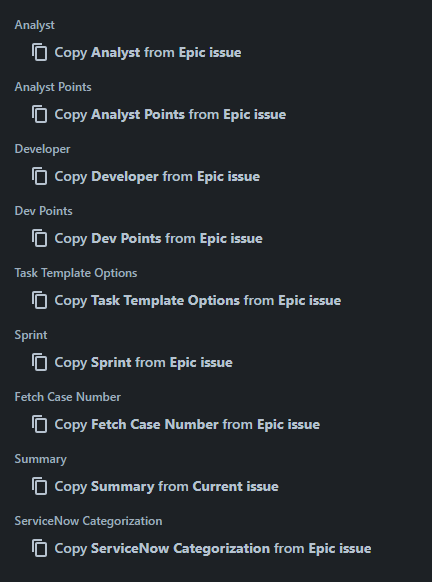

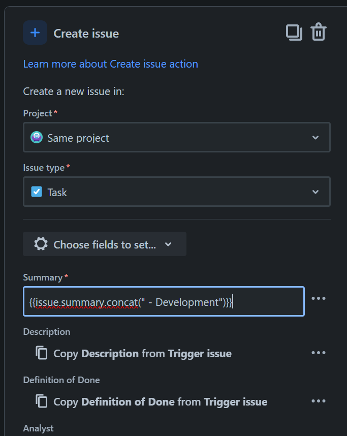

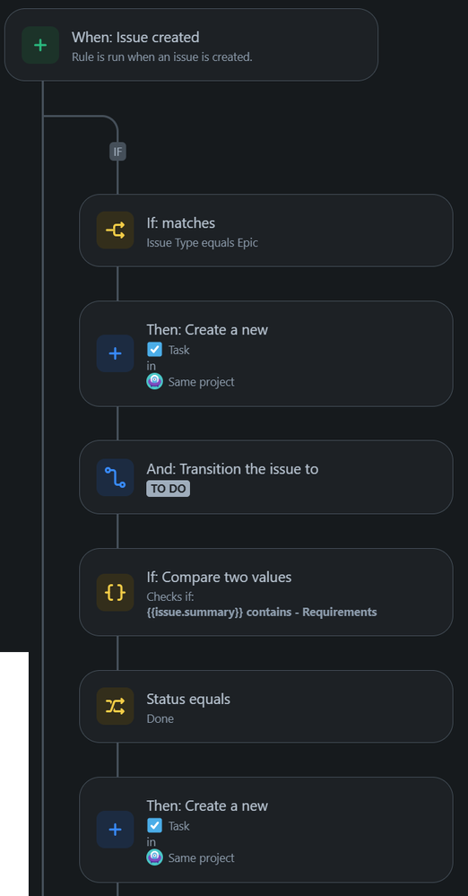

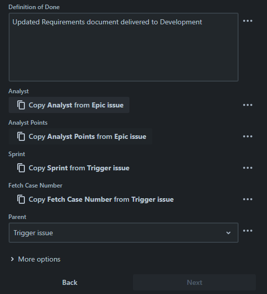

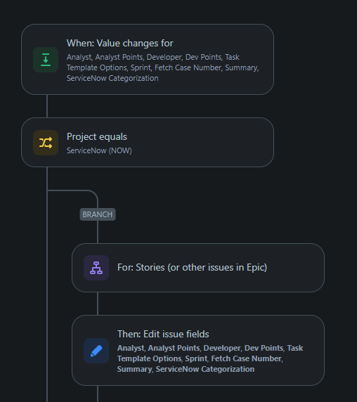

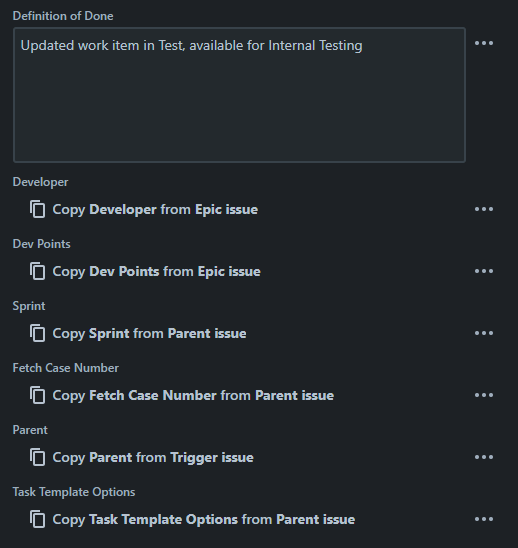

@Bill Sheboy I have been working on this automation and it is 90% working how I want it to with a couple of minor things that aren't working as expected.  I ended up making rules for each of the transitions as it seemed to function better and was more manageable. My issues are as follows:
1. Each Task created under the Epic, when marked as Done, is getting moved back to To Do status
2. The initial automation that's creating the first Requirements task is copying both the Developer/Analyst and Dev/Analyst Points fields when it should only being copying the Analyst fields.  All other tasks are functioning properly with each setting the same for copying from the Epic. I've also tried every other option to copy from with no success.
The screenshots below are in order of the process.  Epic>Requirements Task>Dev Task as well as the automation for copying specific fields down to each task.  There are more automations that follow, but they are just repeating the process.

Bill Sheboy
February 19, 2024
You do not have names shown for your rules, so I will references them by the triggers used.  And given the number of images posted and symptoms you are describing, I recommend trying to diagnose / fix one symptom at a time.  Then we can proceed to the next one.
For the rule triggered on transitioned to Done, you note it is moved back to To Do.  As written, that is indeed what the rule is doing.  If you want the newly created Task to transition to done, the rule needs to branch to Most Recently Created Issue before the transition action.
For the rule triggered on issue created, you describe:
Based on what you show (unless I am confusing which images go with which rule's steps) I see the Analyst and Analyst Points fields set.  I do not see the Developer and Dev Points fields set.  If I am incorrect, please repost just that Create Issue action's image.
February 19, 2024
Thank you for that information.  It looks like modifying the first item resolved the second item, so a 2 for 1!
I really appreciate all your help and this has been a great learning experience for me.  I still have some modifications, and automations, to work on, but I have some good tools in my belt now.
