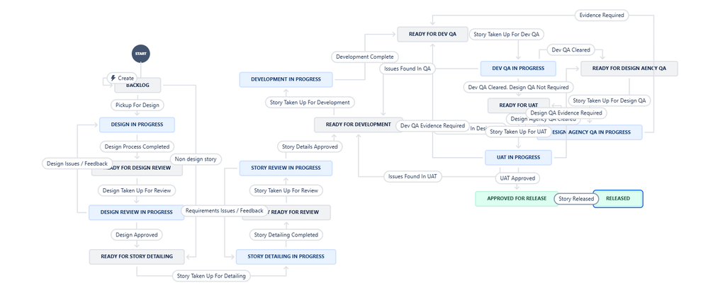

Hi I am facing the same issue, the below is my workflow, know its complex but its necessary so when I complete sprint it doesn't shows as completed in Sprint
please help!
